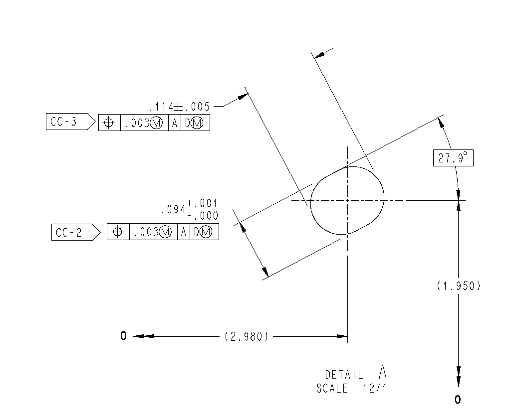

[Pa...] Posted January 30 Share Posted January 30 Hello Zeiss Community! I'm struggling with this one. Below is the drawing callout. I found a knowledge base article that I can use to get the CC-2 callout, however I am finding nothing to walk me through how to manage the CC-3 callout. How the heck would I mange this in Calypso (2025)? Please use small words. I've only been through basic. Article I found: https://portal.zeiss.com/knowledge-base?query=MMC+slot&id=522754 - It looks like I can use the same method shown here for CC-2. Link to comment https://qualityforum.zeiss.com/topic/25701-slot-elongated-hole-position-with-mmc/ Share on other sites More sharing options...
[RP...] Posted January 30 Share Posted January 30 CC-2 you can use the same technique in that article. Probably need a sym plane with angularity for the 27.9° basic. CC-3 you might get away with recalling the 2 arc segment points into a circle feature for the size and location Link to comment https://qualityforum.zeiss.com/topic/25701-slot-elongated-hole-position-with-mmc/#findComment-145387 Share on other sites More sharing options...
