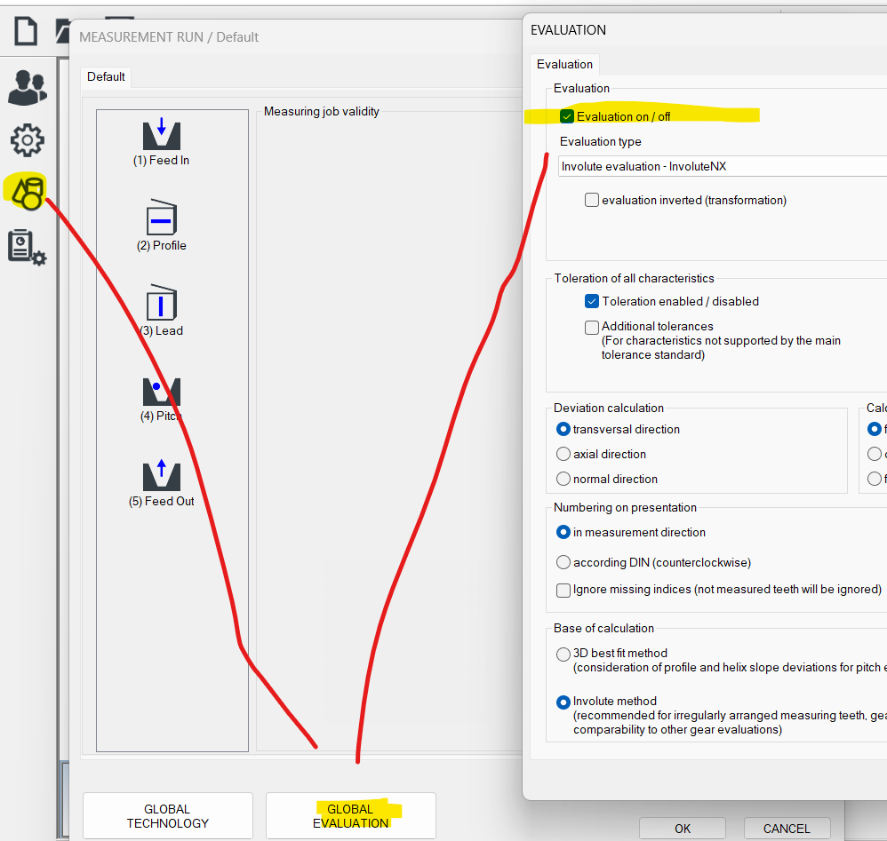

[Do...] Posted February 5 Author Share Posted February 5 Hi Roman, After stumbling around a bit I've learned a few things. 1. The GEAR PRO preview is still not populating. I've gone through the manual and it seems that it would be tied to Setup Evaluation > Evaluation on/off check box. Is it possible that the preview is not available in simulation and/or is it because the CALYPSO program is set to run from features list? Still figuring this one out. 2. The gear results are being generated once the run has completed if I were to save the file as PDF. I was testing the different PiWeb templates and was able to get the GEAR PRO results to attach to the CALYPSO report by adding a Picture View page into the report. Coincidentally, I found that you had mentioned this in another post: 3. My issue now is that the GEAR PRO results are also being treated as plots as well (essentially the same report being condensed to fit into landscape orientation after the full picture page). Is there a way to prevent these gear images from being processed as plots? I've tried combinations of marking and masking, but those didn't seem to do the trick. Link to comment https://qualityforum.zeiss.com/topic/25705-probing-areas-and-missing-teeth-and-a-missing-report/#findComment-145669 Share on other sites More sharing options...

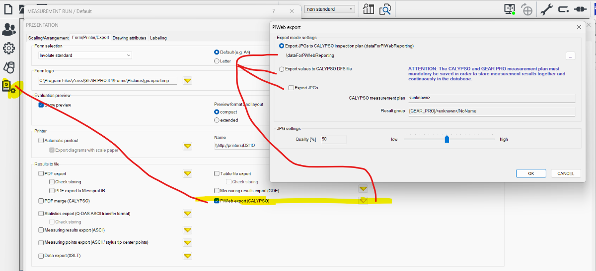

[Ro...] Posted February 6 Share Posted February 6 Hi, regarding #1 preview on/off is different from evaluation on/off: #3 Either you get only the picture plot from GEAR PRO attached in PiWeb or you only want the numerical values from GEAR PRO in PiWeb or both together. Can be configured here: Link to comment https://qualityforum.zeiss.com/topic/25705-probing-areas-and-missing-teeth-and-a-missing-report/#findComment-145711 Share on other sites More sharing options...
[Do...] Posted February 6 Author Share Posted February 6 Greetings Roman, Thank you for your responses. Regarding Item #1 - I had all of the settings selected as you had noted and I was still unable to see the preview. Turns out, I was able to get it to appear after clicking the "Scale to entire page" button at the top of the window. I'm not sure why it wouldn't have been set that way by default, but it looks like it addressed the issue. Item #3 - I've tried fiddling with those settings and I seem to have the same issue. If I want to keep the the GEAR PRO images, they are populated on both the Picture view and the Plot sheets within PiWeb. An alternative would be to rotate the Plot sheet to the vertical orientation and remove the Picture view page altogether. In doing so, the formatting of the plot page does not scale to it's new size automatically and adjusting the items individually is proving to be a challenge. Is there a formatted vertical plot page within the Calypso templates someplace that I could pull into my report? Thanks again, Don M. Link to comment https://qualityforum.zeiss.com/topic/25705-probing-areas-and-missing-teeth-and-a-missing-report/#findComment-145759 Share on other sites More sharing options...
