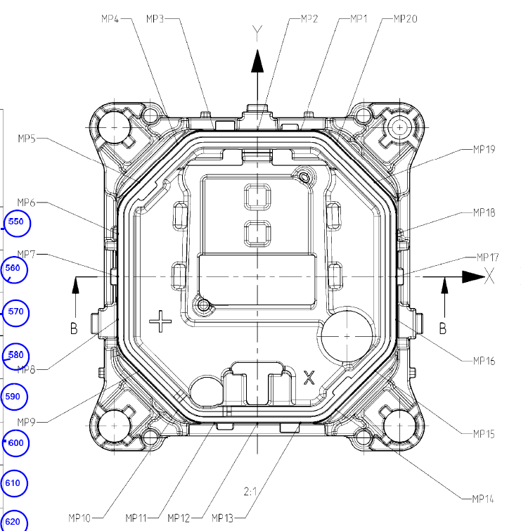

[Jo...] Posted February 2 Share Posted February 2 Hello, i need to build several sections with identical inspections. I am looking for a way to create the cluster copies for MP 4, 5, 9, 10, 14, 15, 19 and 20 from the "father"-cluster located at MP1. I would need to define a 2D-Shift and a rotation at the same time. Is there a way to do this or has anyone found a better workaround than creating a second cluster for those locations? Link to comment https://qualityforum.zeiss.com/topic/25713-create-cluster-copies-that-need-both-2d-shift-and-a-rotation/ Share on other sites More sharing options...
[Na...] Posted February 4 Share Posted February 4 Hello, I think working with two clustesr is a good solution to the problem. It is also possible to mirror elements, maybe that helps with this symmetric part. ZEISS Quality Tech Guide Nanno Link to comment https://qualityforum.zeiss.com/topic/25713-create-cluster-copies-that-need-both-2d-shift-and-a-rotation/#findComment-145539 Share on other sites More sharing options...
