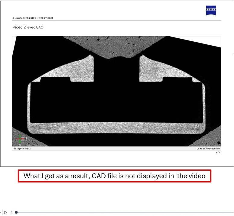

I've been doing videos using X-ray for some time now.
Usually we only make translation videos into the inspected volume to show our clients.

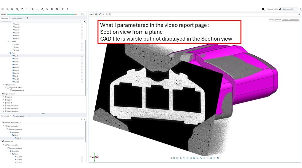

This time I wanted to display the CAD file in the video to show the dynamic CAD cut overimposed on the volume during the video.
But it seems the CAD file doesn't appear correctly.
I attach to this help request several images to explain.
Thanks in advance for any help you can provide !

Thank you for the detailed screenshots. From what I can see, the CAD model is visible in the section view within the workspace, but the CAD contour is not being included when the report page is exported as a video. The exported video appears to contain only the volume section data. Looking at the images, I would lean toward this being either a limitation of the video renderer or a defect in the export process rather than a project setup issue.
I don't understand what you are doing.  Are you prealigning a mesh and a volume at the same time to a CAD model?  I don't know how to do this.
That black plane on the volume cut can be removed by going to 2d sections when the volume is highlighted and deselecting shaded in 2026 or in 2021 using the dropdown to off.
Can you explain how you are lining up a volume and mesh at the same time to a CAD model.  We don't have a need for this, but it is interesting.
