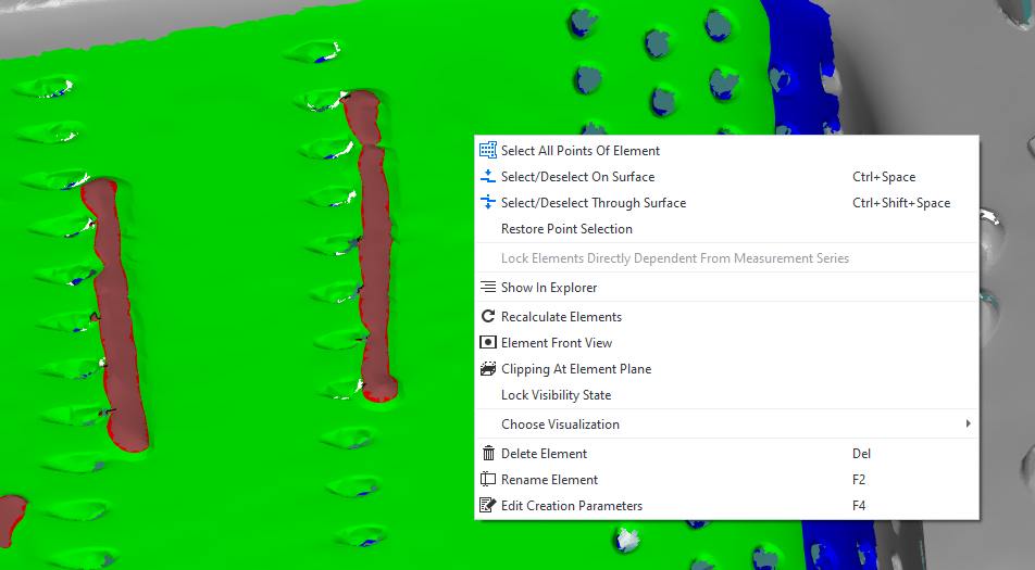

[Qu...] Posted February 3 Share Posted February 3 Hi I am trying to isolate areas of mesh that are proud / material-on relative to a surface. While I can select by value on the surface inspection I cannot currently 'transfer' that selection onto the mesh. Restore point selection relates to the colour map itself and not any subsequent 'sub-selection'. Are there any tools that I am missing, or a scription method to transfer this selection? Greatly appreciate any help Link to comment https://qualityforum.zeiss.com/topic/25727-select-by-value-relate-to-mesh/ Share on other sites More sharing options...

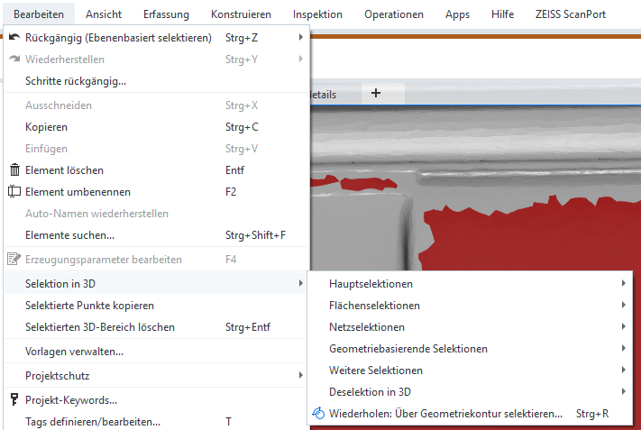

[Jo...] Posted February 3 Share Posted February 3 (edited) Hello Quintus, there are more selection options under Edit --> selection in 3D. You can also pull them in the Quick bar. After reading a little bit thourougvher again and trying it out: I can`t answer your question 🙂 Edited February 3 Link to comment https://qualityforum.zeiss.com/topic/25727-select-by-value-relate-to-mesh/#findComment-145483 Share on other sites More sharing options...
[No...] Posted February 3 Share Posted February 3 I think it's not possible to transfer the selection of an element to another. Additionaly, a selection made on a surface comparison is different from a normal selection. For instance, normal selections can be copied to the clipboard, while surface comparison selections cannot. I guess if there is a way to do it, it will probably be by scripting. Some time ago I needed to transfer the deviation labels of one comparison to another. The support showed me a way to do it by scripting. Unfortunately I very rarely use scripting, so I don't know if something like that can be done with selections too. Link to comment https://qualityforum.zeiss.com/topic/25727-select-by-value-relate-to-mesh/#findComment-145485 Share on other sites More sharing options...

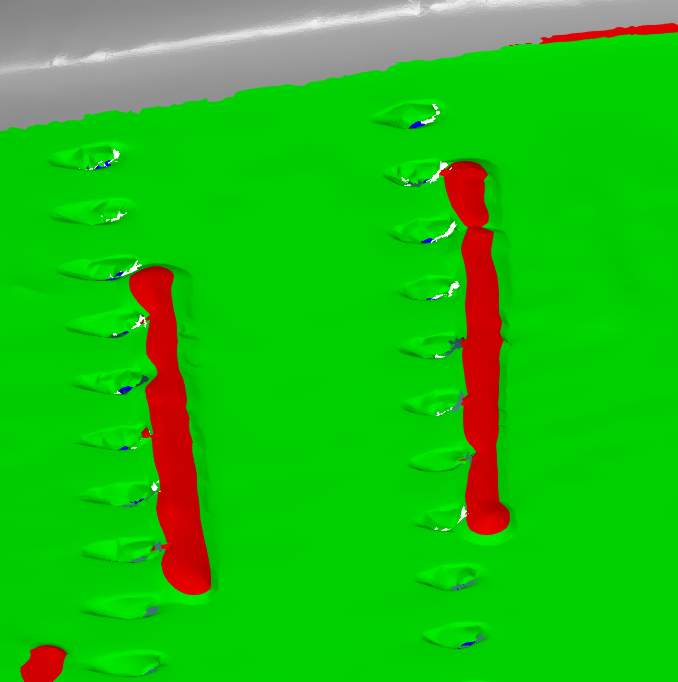

[Na...] Posted February 3 Share Posted February 3 Hi, maybe creating a surface defect element from this helps: ZEISS Quality Tech Guide It can also be classified and checked for area, max. deviation etc.. It is also possible to filter by size and other parameters, so tiny areas are not taken into account for example. A defect element can be exported as STL if you need it as a mesh. Could you also describe why you need this function and what is the application behind this? We could record it as a wish and implement it into the software or there is another approach to the problem. Nanno Link to comment https://qualityforum.zeiss.com/topic/25727-select-by-value-relate-to-mesh/#findComment-145489 Share on other sites More sharing options...
[Jo...] Posted February 3 Share Posted February 3 Maybe if you use "select above plane" and invert the selection, you get something similar to "select by value" at least for flat surfaces. Link to comment https://qualityforum.zeiss.com/topic/25727-select-by-value-relate-to-mesh/#findComment-145491 Share on other sites More sharing options...

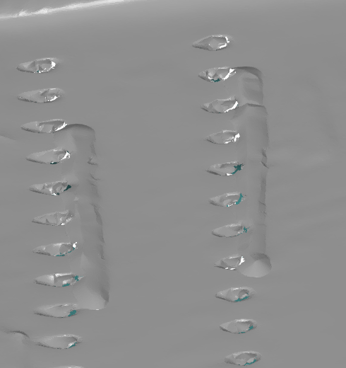

[Qu...] Posted February 3 Author Share Posted February 3 Thanks for your responses / suggestions. I am looking to find material proud of a free-form surface and then extract the 3d coordinates of that material for downstream machining operations. The percentage of the surface that may have material on can vary significantly as well as the size and shape of the added material. Unfortunately surface defect relies on a high proportion of surrounding 'good' or 'defect free' material in addition to a consistent defect size to work parametrically in any reliable manner. I suspect a scripted 'transfer' to mesh or coordinate extraction is the way forward. Link to comment https://qualityforum.zeiss.com/topic/25727-select-by-value-relate-to-mesh/#findComment-145509 Share on other sites More sharing options...

[Na...] Posted February 4 Share Posted February 4 Please sign in to view this username. , the defect element can be created from a surface comparison (I guess your screenshot is a surface comparison?). Via script you could get the selection on the surface comparison similar to this FAQ: Frequently asked questions — App Development Documentation # -*- coding: utf-8 -*- import gom import numpy as np print(gom.app.project.inspection['Surface comparison 1'].selection.coordinate) # Output: gom.Array (element=gom.app.project.parts['Training Object'].actual.selection.coordinate, shape=(1, 1343, 3)) #gom.app.project.inspection['Surface comparison 1'] selection = np.array(gom.app.project.inspection['Surface comparison 1'].selection.coordinate) print(selection) Link to comment https://qualityforum.zeiss.com/topic/25727-select-by-value-relate-to-mesh/#findComment-145543 Share on other sites More sharing options...
