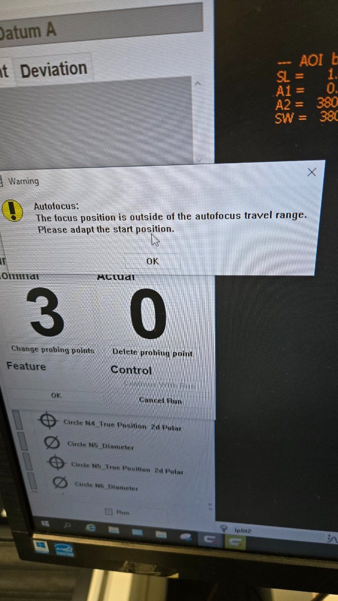

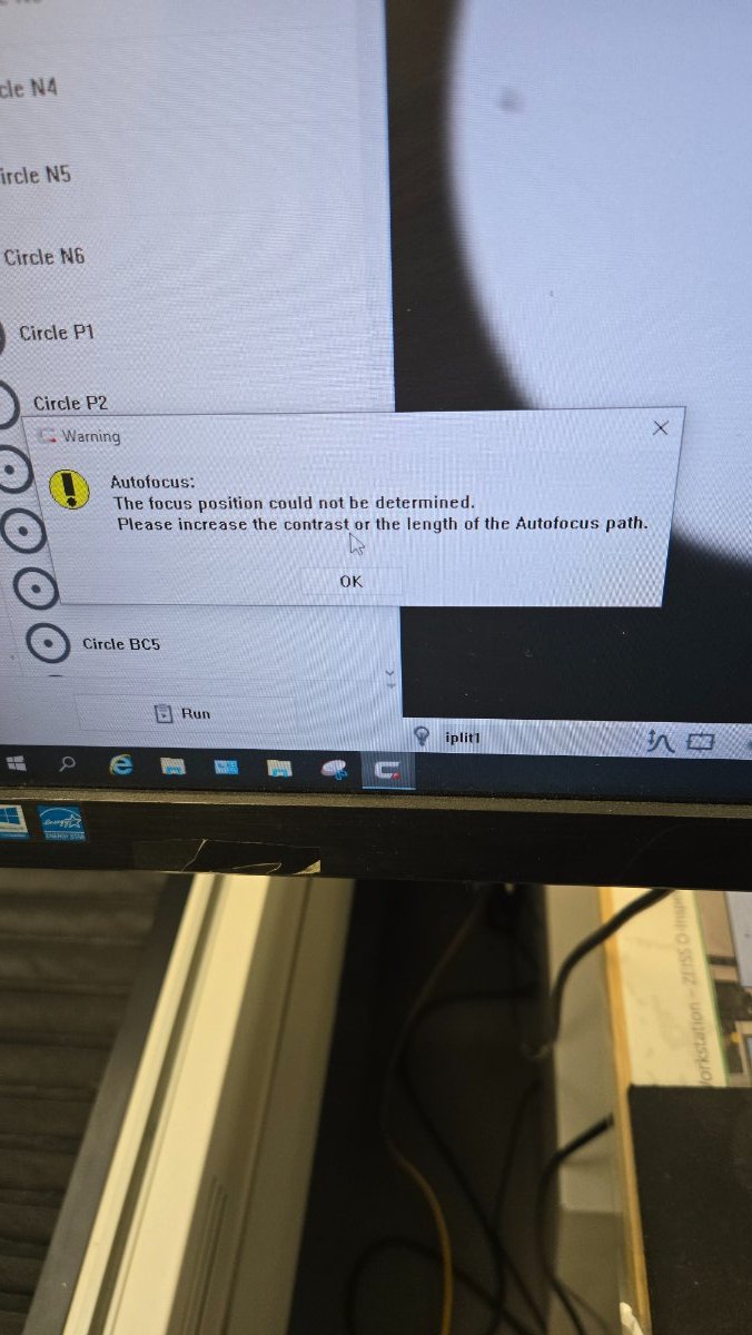

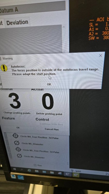

[Ke...] Posted February 3 Share Posted February 3 One for the O-Inspect people. I'm trying to run a program that hasn't been ran in a couple years and I'm getting these 2 pop up errors when trying to run the program. I've tried adjusting the settings in the strategy, but nothing seems to help. Thank you! Link to comment https://qualityforum.zeiss.com/topic/25733-o-inspect-error-messages/ Share on other sites More sharing options...
[Cl...] Posted February 3 Share Posted February 3 I'd start by making sure the tactile/optical/adjustment and check offset is up to date. Then re-do the calibration using the small glass plate with the targets on it. Link to comment https://qualityforum.zeiss.com/topic/25733-o-inspect-error-messages/#findComment-145503 Share on other sites More sharing options...
[Ra...] Posted February 3 Share Posted February 3 I think you can increase the travel focus distance and it can solve your problem. Link to comment https://qualityforum.zeiss.com/topic/25733-o-inspect-error-messages/#findComment-145507 Share on other sites More sharing options...
[No...] Posted February 4 Share Posted February 4 (edited) A frequent problem I encountered is when the autofocus detects the same amount of max. contrast (AF is contrast-based asd you certainly know) at different heights, it is unable to determine which is the correct one and errors out. This happens frequently with thin molded plastic parts where flash occurs and tricks the AF. In cases like this it's better to reduce the AF distance or raise the starting point, so it stops before the second edge. Edited February 4 Link to comment https://qualityforum.zeiss.com/topic/25733-o-inspect-error-messages/#findComment-145515 Share on other sites More sharing options...
