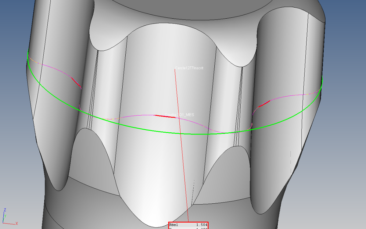

[ni...] Posted February 4 Share Posted February 4 Bonjour, Sur l image ci dessous, je mesure ma pièce avec une Curve. Je dois mesurer le diametre minimum de ma pièce grâce aux points de ma courbe. Cependant, je ne sais pas les différences entre "Inscrit GN" , "Minimum GC", "Tangent Interieur matiere GN". Le diametre que je veux mesurer est un diametre mini exterieur (trait rouge sur l image) Link to comment https://qualityforum.zeiss.com/topic/25741-difference-between-inscrit-gn-minimum-gc-tangent-interieur-matiere-gn/ Share on other sites More sharing options...
[Du...] Posted February 4 Share Posted February 4 Filters_Outliers_EvaluationSettings.pptthis may help but i think you would need to use the Max inscribed Link to comment https://qualityforum.zeiss.com/topic/25741-difference-between-inscrit-gn-minimum-gc-tangent-interieur-matiere-gn/#findComment-145529 Share on other sites More sharing options...
[Ca...] Posted February 4 Share Posted February 4 I agree with Dustin and that is a good resource/PowerPoint - Here is a link to the Knowledge Base, as well, showing the evaluation methods: https://portal.zeiss.com/knowledge-base?id=420544 Link to comment https://qualityforum.zeiss.com/topic/25741-difference-between-inscrit-gn-minimum-gc-tangent-interieur-matiere-gn/#findComment-145573 Share on other sites More sharing options...
