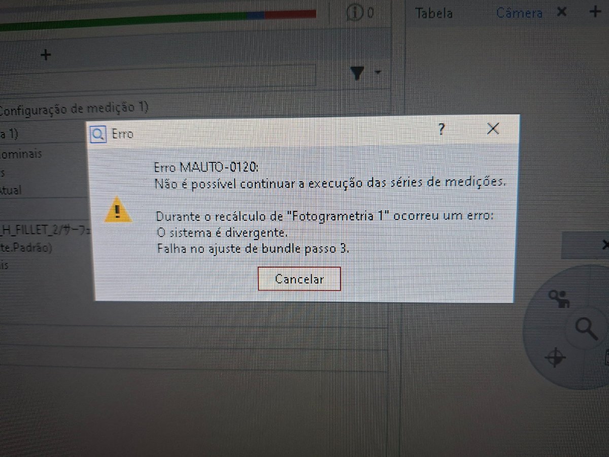

[Le...] Posted February 4 Share Posted February 4 Please,Could someone help me with this error in GOM Inspect? It occurs after photogrammetry. I searched but couldn't find a correct solution. Thanks!! ###ERROR MAUTO-0120##### Link to comment https://qualityforum.zeiss.com/topic/25743-error-mauto-0120/ Share on other sites More sharing options...
[Na...] Posted February 4 Share Posted February 4 Hi Leonardo, the bundle block adjustment failed. Could be not enough pictures or bad viewing angles, duplicated markers, wrong scale bars for example. There is a hint in the properties of the photogrammetry measurement series and in the project guide. I recommend to contact your local support with the project including the measurements for an analysis. Nanno 1 Link to comment https://qualityforum.zeiss.com/topic/25743-error-mauto-0120/#findComment-145537 Share on other sites More sharing options...
