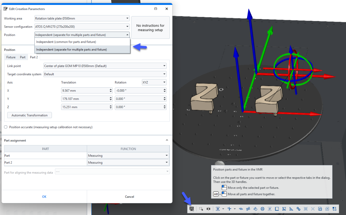

[Le...] Posted February 4 Share Posted February 4 no scanbox 5120 podemos scanear mais de uma peça dentro de um mesmo programa? preciso scanear 6 peças e vou fazer 6 programas diferentes,gostaria de saber se existe a possibilidade de scanear todas de uma vez dentro de um mesmo programa já que cada peça vem em locais diferentes no espaço,são de pontos diferentes do carro. Please sign in to view this quote. Link to comment https://qualityforum.zeiss.com/topic/25749-scanbox-escanear-mais-de-uma-pe%C3%A7a/ Share on other sites More sharing options...
[Na...] Posted February 5 Share Posted February 5 Hi Leandro, please ask in English or German so everyone can understand the request easily 🙂 You can have more than one part in the project. The location of the individual parts and related settings can be defined in the measuring setup. Nanno Link to comment https://qualityforum.zeiss.com/topic/25749-scanbox-escanear-mais-de-uma-pe%C3%A7a/#findComment-145599 Share on other sites More sharing options...
[Le...] Posted February 5 Author Share Posted February 5 Hi Nanno, But when I import the parts, they come in with different coordinates. In the measurement settings, it changes all the parts together. Is there another way to measure multiple parts all at the same origin coordinates? Link to comment https://qualityforum.zeiss.com/topic/25749-scanbox-escanear-mais-de-uma-pe%C3%A7a/#findComment-145667 Share on other sites More sharing options...
[Na...] Posted February 6 Share Posted February 6 Hi Leandro, there is an option for moving the parts individually in the measuring setup. After the setup, you can change the view between inspection (parts in their coordinate system) and the measuring view (representing measuring setup): Please reach out to your local support for setting up a multipart project, if something is wrong with the measuring setup, hardware crashes can happen. The Kiosk should be modified accordingly for example for export of result data. Nanno Link to comment https://qualityforum.zeiss.com/topic/25749-scanbox-escanear-mais-de-uma-pe%C3%A7a/#findComment-145757 Share on other sites More sharing options...
