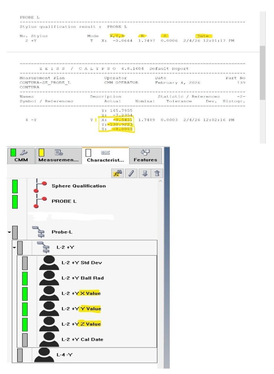

[is...] Posted February 4 Share Posted February 4 Hi All, I would like to get the XYZ values to be saved in a characteristics. But unfortunately, I cannot find it on the getProbe() instances. Is there any way this can be extracted from the probe data? Thanks in advance. Link to comment https://qualityforum.zeiss.com/topic/25755-how-to-get-x-y-z-values-from-probe-calibration/ Share on other sites More sharing options...
[Ch...] Posted February 4 Share Posted February 4 getProbe().probeVector.x getProbe().probeVector.y getProbe().probeVector.z 1 Link to comment https://qualityforum.zeiss.com/topic/25755-how-to-get-x-y-z-values-from-probe-calibration/#findComment-145575 Share on other sites More sharing options...
[Ke...] Posted February 4 Share Posted February 4 (edited) In the F1 help menu, search for "getProbe", this should give you a full list of available items, along with their syntax Edited February 4 Typo Link to comment https://qualityforum.zeiss.com/topic/25755-how-to-get-x-y-z-values-from-probe-calibration/#findComment-145577 Share on other sites More sharing options...
[Cl...] Posted February 4 Share Posted February 4 (edited) Do you need both stylus system and stylus? getProbe("1_-Z,OI6_Star").probeVector Will this work in a Result Element? Edited February 4 Link to comment https://qualityforum.zeiss.com/topic/25755-how-to-get-x-y-z-values-from-probe-calibration/#findComment-145581 Share on other sites More sharing options...
[Ke...] Posted February 4 Share Posted February 4 You should use both, yes. There are cases where you could feasibly leave it blank to get just the current active probe or a certain probe from the current styli, but those are highly niche and rare. Additionally, your syntax is missing 2 quotation marks, it should be getProbe("1_-Z","OI6_Star").probeVector (you can also need to add the specific direction after the probeVector, unless you want it as a vector list of all 3 at once). It should work in a result element as a formula Link to comment https://qualityforum.zeiss.com/topic/25755-how-to-get-x-y-z-values-from-probe-calibration/#findComment-145585 Share on other sites More sharing options...
[is...] Posted February 5 Author Share Posted February 5 Thanks for the vectors. However, probDate() result is in MM/DD/YY format and wont work in Result Element, is there any workaround for this? If I can extract in YYMMDD format without "/" that would be great. Link to comment https://qualityforum.zeiss.com/topic/25755-how-to-get-x-y-z-values-from-probe-calibration/#findComment-145619 Share on other sites More sharing options...
[is...] Posted March 27 Author Share Posted March 27 Update: Instead of using results element for the calibration date, it was added in the comment. Thanks to Michael Schultze for sharing the knowledge. Link to comment https://qualityforum.zeiss.com/topic/25755-how-to-get-x-y-z-values-from-probe-calibration/#findComment-148338 Share on other sites More sharing options...
