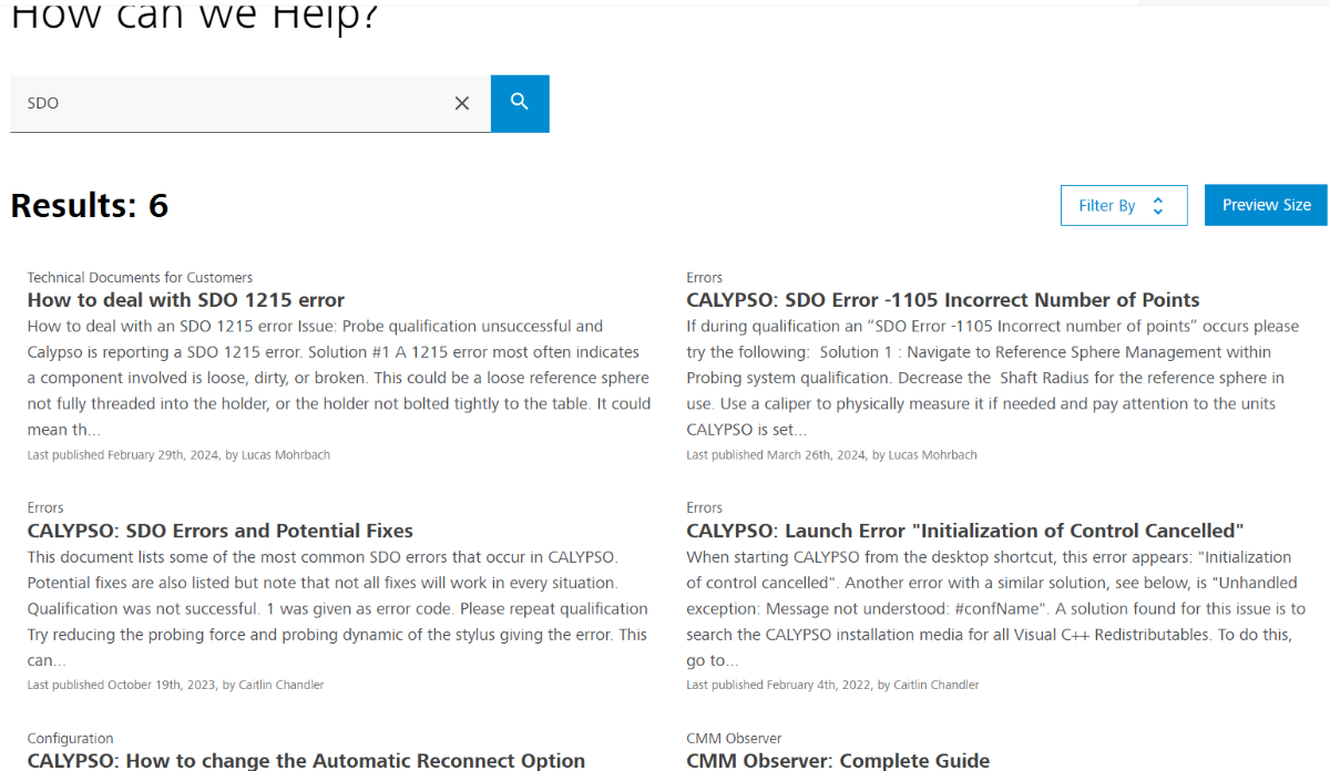

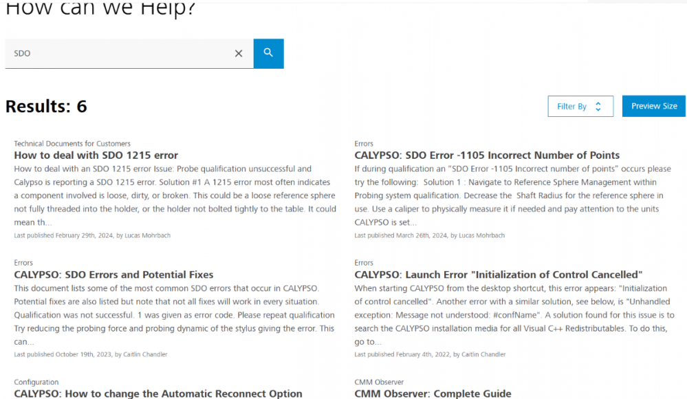

[Ch...] Posted February 13 Share Posted February 13 you cand try the Knowledge base on the portal, but I agree there should be more of a list, the thing is there is a large possibility of potential errors. Many can be found searching here on forums. SDO /SDCO is related to stylus database object I believe, or the probe file in the software. Link to comment https://qualityforum.zeiss.com/topic/25761-how-can-i-get-reason-of-calypso-error-message/#findComment-146147 Share on other sites More sharing options...
