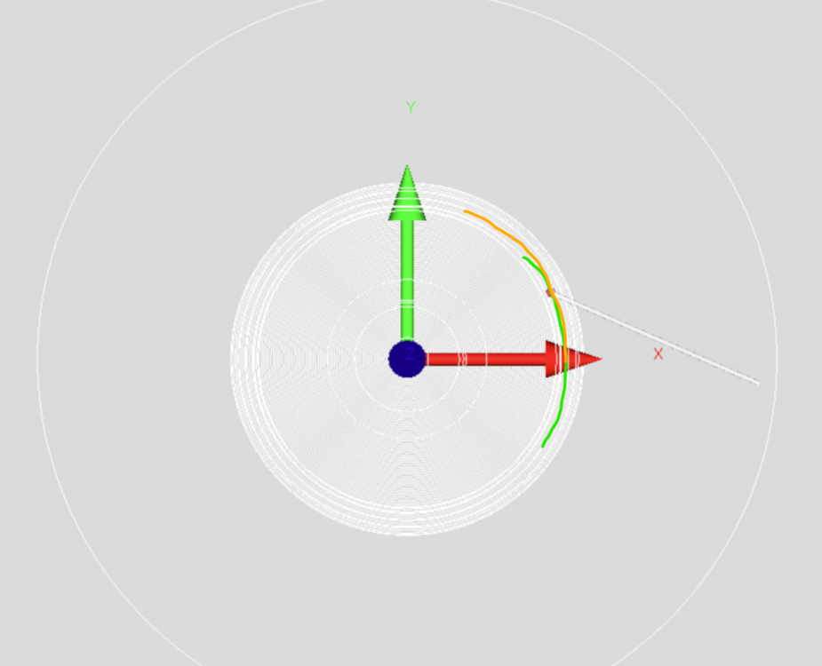

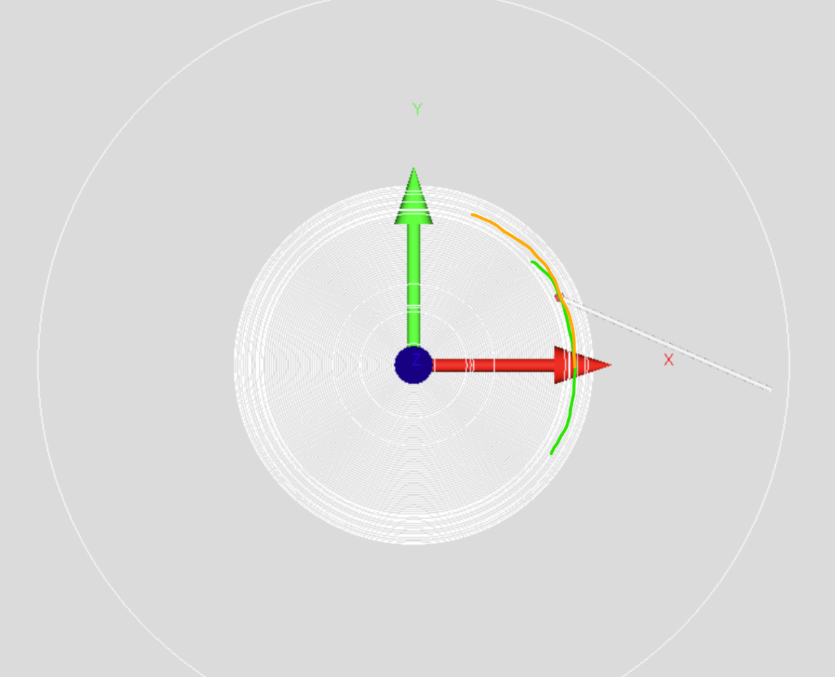

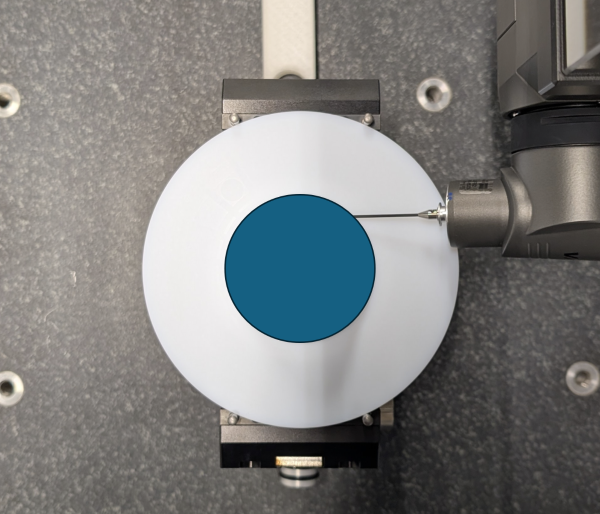

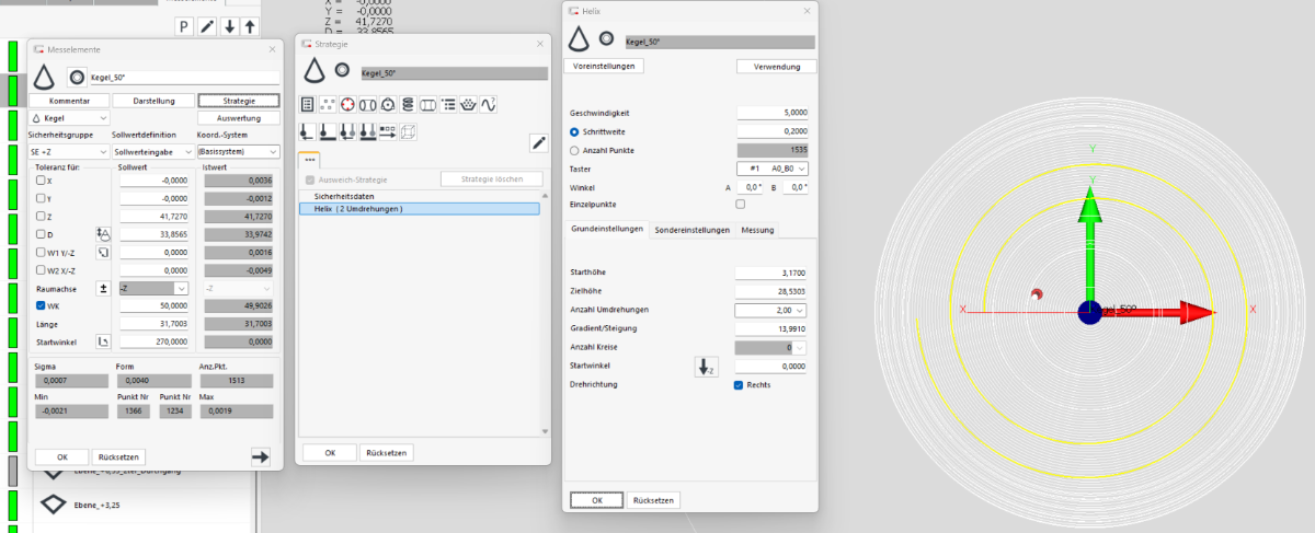

[Ti...] Posted February 5 Share Posted February 5 Hello everyone, This is my first post, so please let me know if I've forgotten anything! I'm currently running this program on our Spectrum with RDS and have noticed that Calypso does not display the measuring probe symmetrically to the X-axis when it is swiveled, i.e., it is not parallel to the machine coordinate system in X. The first two images were taken at the same moment, but there is a rotation of the probe on the screen of approx. 20°, which is not present on the actual machine. The contour is traced on the machine parallel to the X-axis. When I took a closer look, I also noticed that the circular segment, which should theoretically follow the green contour (first image), is also rotated relative to the component axis. The orange path is followed. This is consistent across all/multiple circular probing operations of the program. The base system for this can be seen in the third image with the plane rotation empty, which means it should be defined as the machine axis (+X). I chose this because the component is rotationally symmetrical and can thus be defined more easily (without probing the vise/chuck it is in). Why are the circular segments not probed symmetrically to the X-axis when rotated? Where does the rotation of the probe come from? I think these things are related, but I don't understand the cause. 1 Link to comment https://qualityforum.zeiss.com/topic/25765-problem-with-rotation-around-rotational-axis/ Share on other sites More sharing options...

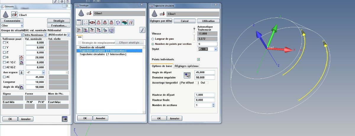

[ni...] Posted February 10 Share Posted February 10 can you post the element and strategy window, and the real trajectory on the part (not a drawing) like this : Link to comment https://qualityforum.zeiss.com/topic/25765-problem-with-rotation-around-rotational-axis/#findComment-145879 Share on other sites More sharing options...

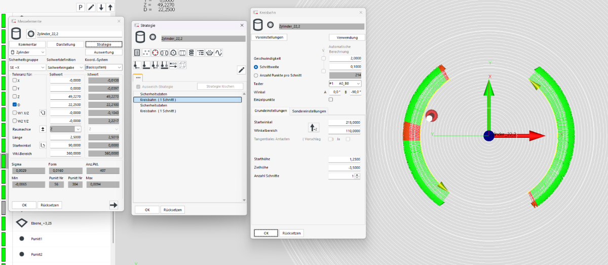

[Ti...] Posted February 10 Author Share Posted February 10 Hello Nicolas, of course, here it is with measured points. It looks as if everything is fine but when probing the axis is rotated on the screen and the scanned segment is not the yellow one on the part but also rotated along the Z-Axis as shown in the orange sketch in my post... Link to comment https://qualityforum.zeiss.com/topic/25765-problem-with-rotation-around-rotational-axis/#findComment-145899 Share on other sites More sharing options...
[Ze...] Posted February 10 Share Posted February 10 As a test I would measure a line on the vise and clock to that. Then you can see if it's CAD model related, machine coordinate issue, etc. Link to comment https://qualityforum.zeiss.com/topic/25765-problem-with-rotation-around-rotational-axis/#findComment-145905 Share on other sites More sharing options...
[ni...] Posted February 10 Share Posted February 10 your cylinder is not on the base system, It was about the Kegel_50° I was asking for. not the problem you are asking but I see you have only one height probing (Anzahl Schnitlle) on you cylinder this why you have a tilt on W2 Y/Z , you might have at least two or prefer to mesuring a circle. Link to comment https://qualityforum.zeiss.com/topic/25765-problem-with-rotation-around-rotational-axis/#findComment-145911 Share on other sites More sharing options...

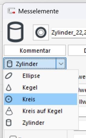

[Ti...] Posted February 10 Author Share Posted February 10 Please sign in to view this quote. I'm sorry, here is the the screenshot for the cone! Thank you for reminding me - I learned that the other day and will switch the element to a circle since I can't scan at multiple heights due to the slot being very narrow. I only want the diameter so it doesn't matter. Do I have to recreate the element or is it okay to just change it here? Link to comment https://qualityforum.zeiss.com/topic/25765-problem-with-rotation-around-rotational-axis/#findComment-145925 Share on other sites More sharing options...
[ni...] Posted February 11 Share Posted February 11 try to recreat it, and see if it close the problem. Cause if I understand well, the scanning is doing well, the matter is just about visualisation ? Link to comment https://qualityforum.zeiss.com/topic/25765-problem-with-rotation-around-rotational-axis/#findComment-145959 Share on other sites More sharing options...
[Ti...] Posted February 11 Author Share Posted February 11 Please sign in to view this quote. No it's not just visualization, the segment should be scanned along the green line but it is scanned along the orange one in real life. The visualisation is just what made me look closer and realize that it isn't scanning the defined segment but a rotated one along the axis... Link to comment https://qualityforum.zeiss.com/topic/25765-problem-with-rotation-around-rotational-axis/#findComment-145961 Share on other sites More sharing options...

[ni...] Posted February 11 Share Posted February 11 create circle in place of cylinder, and do a calibration of all stylus you used in this program. and by two time someone ask to scan a line to clock rotation, you should try. Link to comment https://qualityforum.zeiss.com/topic/25765-problem-with-rotation-around-rotational-axis/#findComment-145965 Share on other sites More sharing options...
[Ti...] Posted February 11 Author Share Posted February 11 Please sign in to view this quote. Yes I changed it from cylinder to circle and all probes are calibrated. What do you mean? I shoud use a element to restrict the 6th degree of freedom? Link to comment https://qualityforum.zeiss.com/topic/25765-problem-with-rotation-around-rotational-axis/#findComment-145985 Share on other sites More sharing options...
