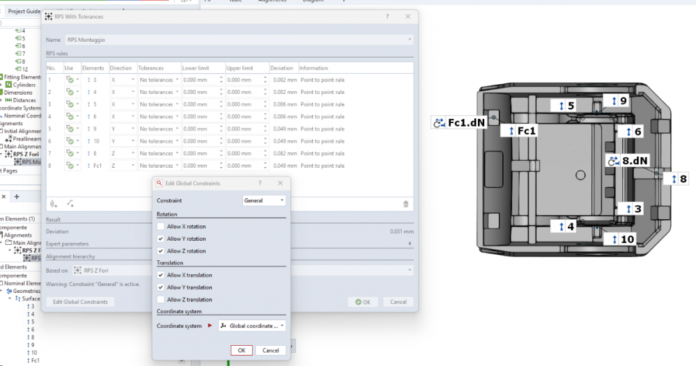

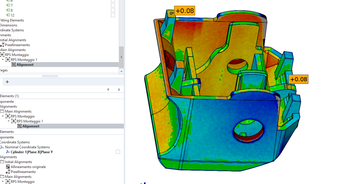

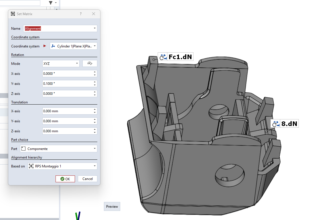

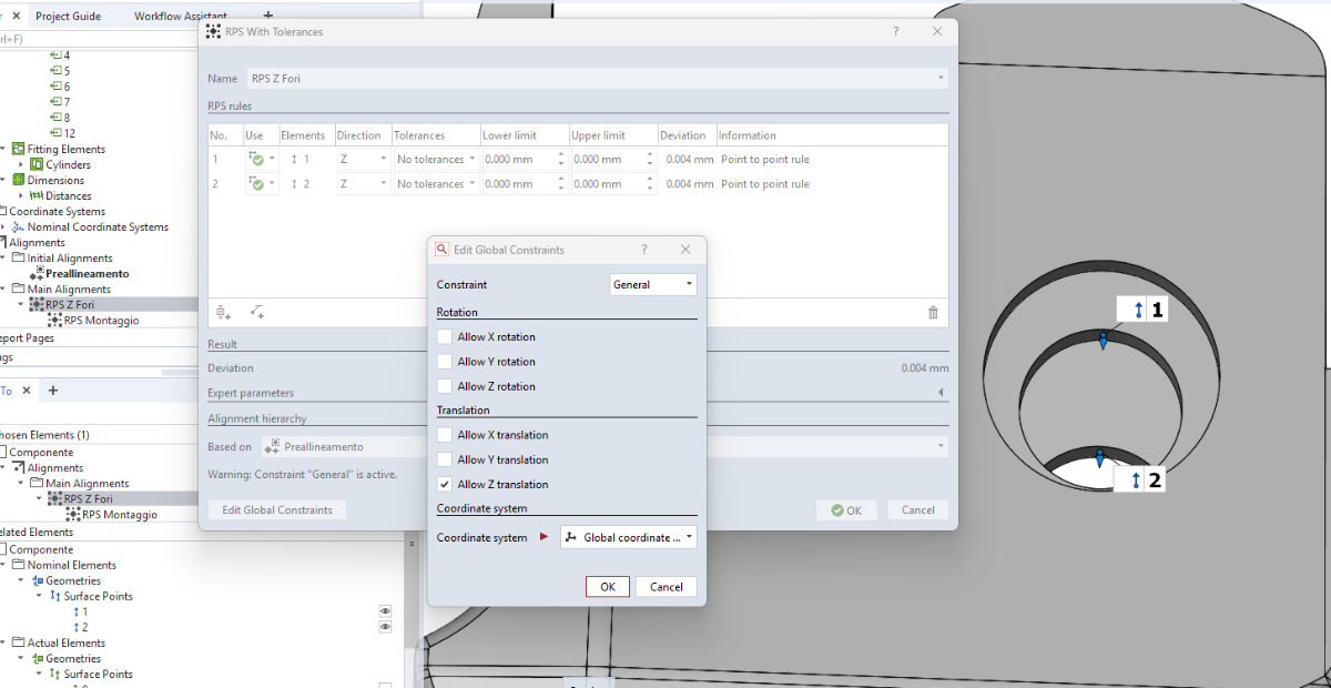

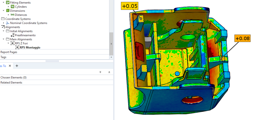

[Ma...] Posted February 5 Share Posted February 5 Good morning to all, I have a problem with RPS Alignment. I have to make a alignment between a knob and the CAD and I have a problem to block the Y rotation movement. X and Y are OK, but in Z I have to put 2 points to zero and divide the errore to the others two points. To do this I have make a first alignment where I put 1 and 2 to zero (first imagine) and a second alignment with all points, letting all the movment free exept for the X rotation (second image). The result is as visible in the third image, where it's shown the problem: the error wasn't divided in equal part. How can I do? I watch to other alignment method, but nothing seems to be useful for me. Thank you very much! Link to comment https://qualityforum.zeiss.com/topic/25769-alignment-problem/ Share on other sites More sharing options...
[Ma...] Posted February 5 Share Posted February 5 I have problems with understanding your problem. What i would do is using circles instead of your points 1 and 2. Or use your RPS montaggio as first and then correct Z value by points 1 and 2. Or if it's confidential we can go by PM Link to comment https://qualityforum.zeiss.com/topic/25769-alignment-problem/#findComment-145677 Share on other sites More sharing options...

[Ma...] Posted February 6 Share Posted February 6 Well what i would do is making those two points in holes after the big rps. Also i would check at measured elements to be evaluated in this first rps. But even after that you will get different deviation because of X rotation. Because one point on left is further from center than you second point on right side. Link to comment https://qualityforum.zeiss.com/topic/25769-alignment-problem/#findComment-145789 Share on other sites More sharing options...
[Ma...] Posted February 9 Author Share Posted February 9 Good morning. I think I tried 10 different solution and I don't understand why, in the two points are not in the same height the alignment doesn't work. I simply make a last alignment with a manual rotation of 0.1° around Y axis and it work! Why gom is not able to do this?? Link to comment https://qualityforum.zeiss.com/topic/25769-alignment-problem/#findComment-145831 Share on other sites More sharing options...
