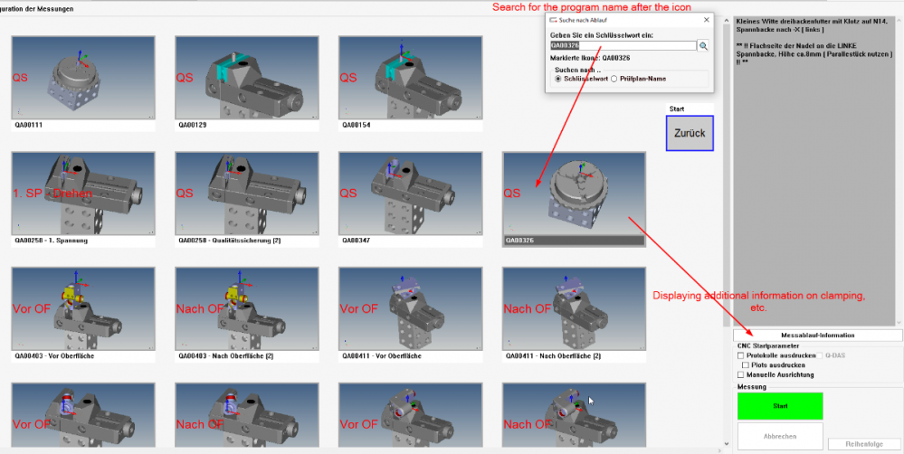

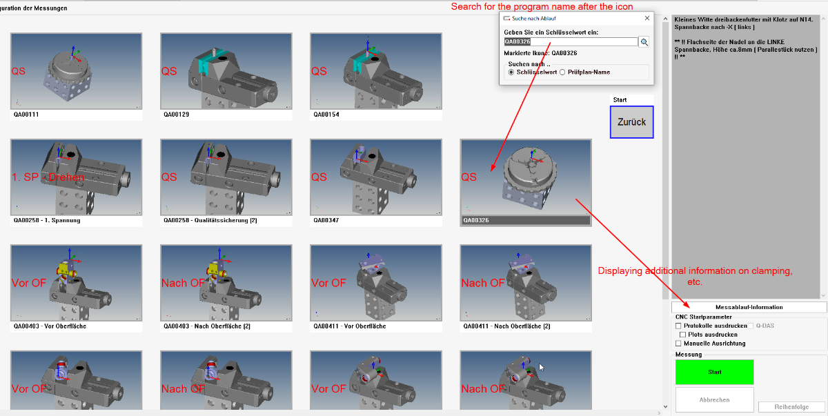

[Ka...] Posted February 6 Share Posted February 6 I can recommend Autorun for this. Your colleagues can search for a program using a unique name key and activate it. It is also possible to display more detailed information about this program, e.g., PDF, JPG, MP4, etc 2 Link to comment https://qualityforum.zeiss.com/topic/25777-reference-image-for-measurement-cycles/#findComment-145727 Share on other sites More sharing options...

[Sv...] Posted February 6 Share Posted February 6 Please sign in to view this username. That's exactly how I do it in our company too. You can also have the measurement sequence information displayed automatically when the CNC machine starts. 1 Link to comment https://qualityforum.zeiss.com/topic/25777-reference-image-for-measurement-cycles/#findComment-145733 Share on other sites More sharing options...
