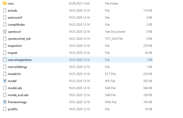

[Ed...] Posted February 11 Share Posted February 11 (edited) Check how big are your programs (MB, GB)? Check that these files are just some kB What version of Calypso? Edited February 11 Link to comment Share on other sites More sharing options...
[Ni...] Posted February 11 Author Share Posted February 11 Please sign in to view this quote. I’ve just updated to the latest version, 8.0.08, and now the loading time has improved from about two minutes to roughly one minute. The size of the program is shown in the attached image. Link to comment Share on other sites More sharing options...
[Ed...] Posted February 11 Share Posted February 11 I had this type of problem with one of old versions. Try to delete files"model.fct" and "model.sab" Just cut them into another folder, you may be able to put them back if it doesn`t help. These files should not be so big! 1 Link to comment Share on other sites More sharing options...
[Ni...] Posted February 11 Author Share Posted February 11 Please sign in to view this quote. Thanks for the suggestion. I tried it, but unfortunately nothing has changed. Link to comment Share on other sites More sharing options...
