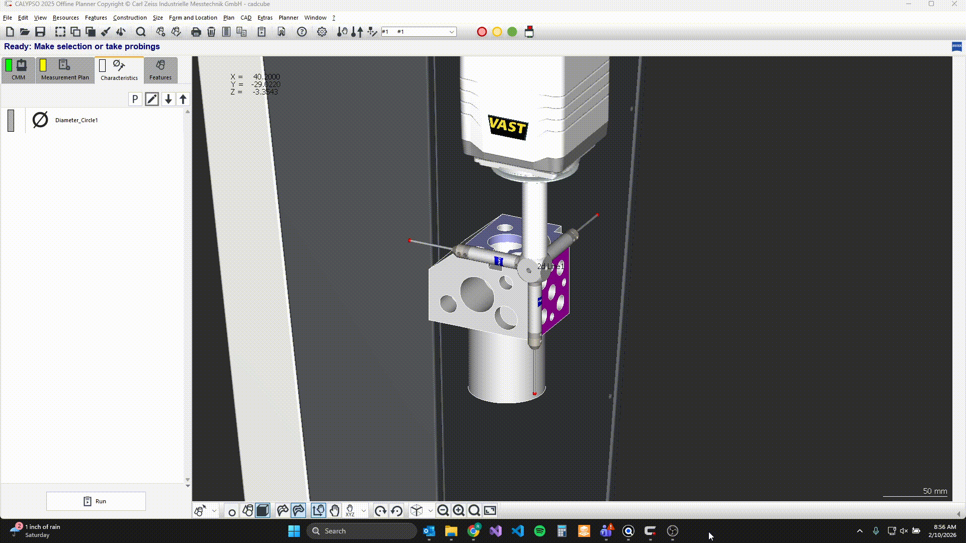

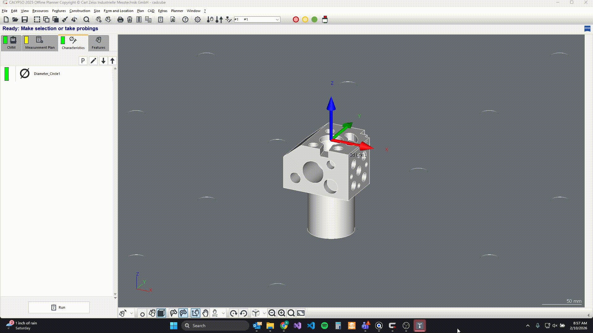

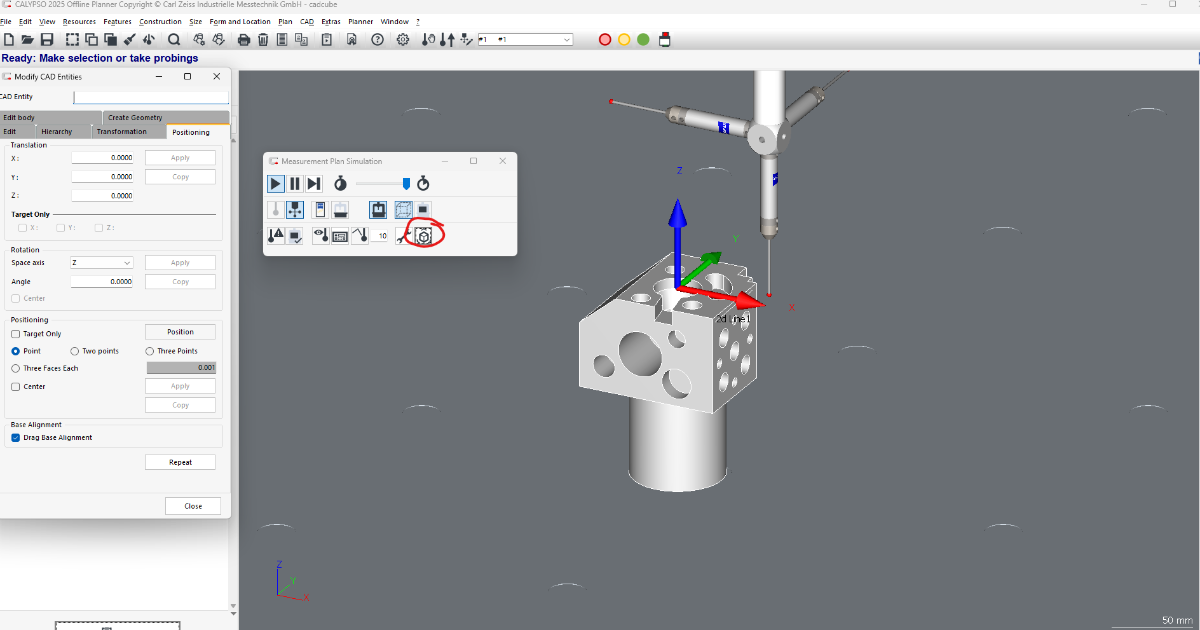

[Ri...] Posted February 10 Share Posted February 10 Just an FYI - Planner/Simulation will not longer simulate correctly if the model for your part is still set to machine coordinate zero (top-left corner). In the past, this was never a requirement, but it appears that it is forced in 8.0 now. You can move this at any point, it will not have any effect on your program if you do it before or after it is programmed. Before model is moved (hard to see, but essentially it just doesn't move). After model is moved. In the Measurement Plan Simulation - select Modify CAD Model - on the Positioning tab - select your CAD Model - enter the appropriate Translation values (you can always start with half of your measuring volume) - click Apply. 1 2 Link to comment Share on other sites More sharing options...

[Ri...] Posted February 11 Author Share Posted February 11 Karsten, The machine simulation is turned on by default, but regardless you have to perform the translation with or without it on. I only showed the machine in this case to showcase why it wasn't working correctly. Link to comment Share on other sites More sharing options...

[Te...] Posted February 16 Share Posted February 16 The RDS Head you have to put it to the table and then offset if 50mm in Z to get to work correctly Link to comment Share on other sites More sharing options...
