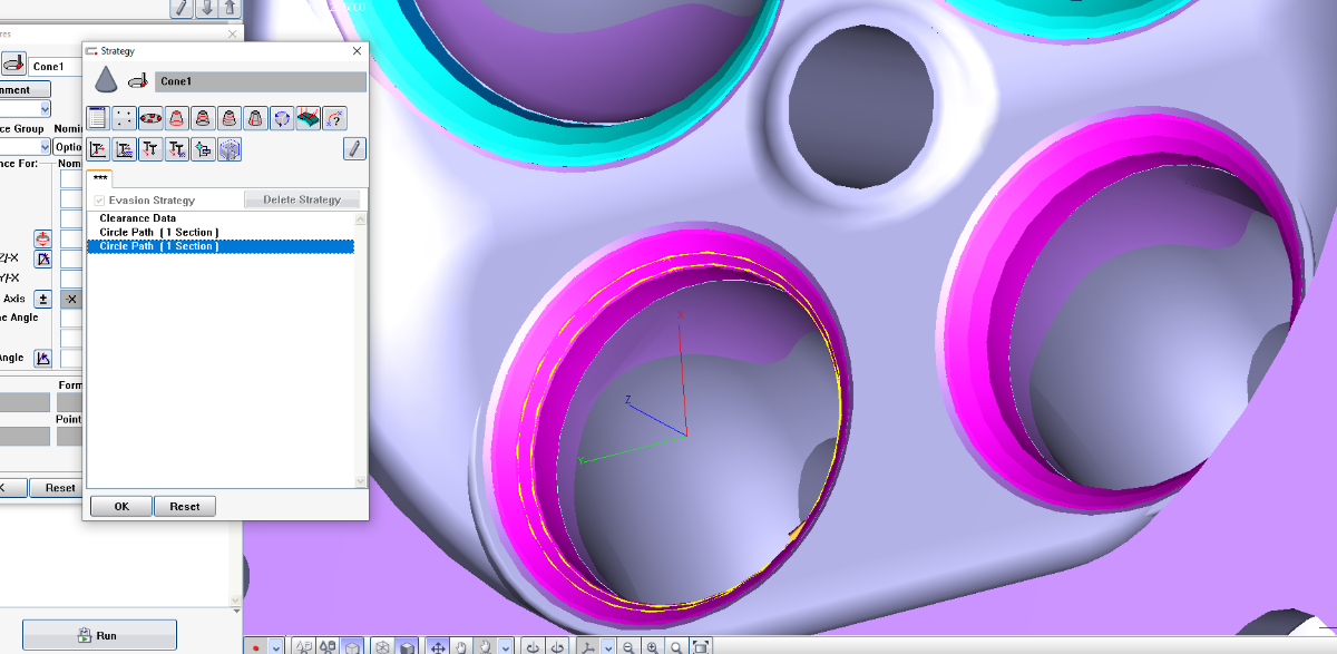

[Da...] Posted February 12 Share Posted February 12 Hi all, Does anyone of you check seats of the cylinder head on a daily basis ? I am wondering how do you 'find' and measure the seats very accurate ? We measure 2 lines on the seat and outer relief and then create intersection point and use this for a local alignment. Any other ideas ? I do not have the PCM license. All I am after is just to make sure that the probe measure the seat even if they are offset like too shallow etc. Link to comment https://qualityforum.zeiss.com/topic/25829-cylinder-head-seats-and-guides/ Share on other sites More sharing options...

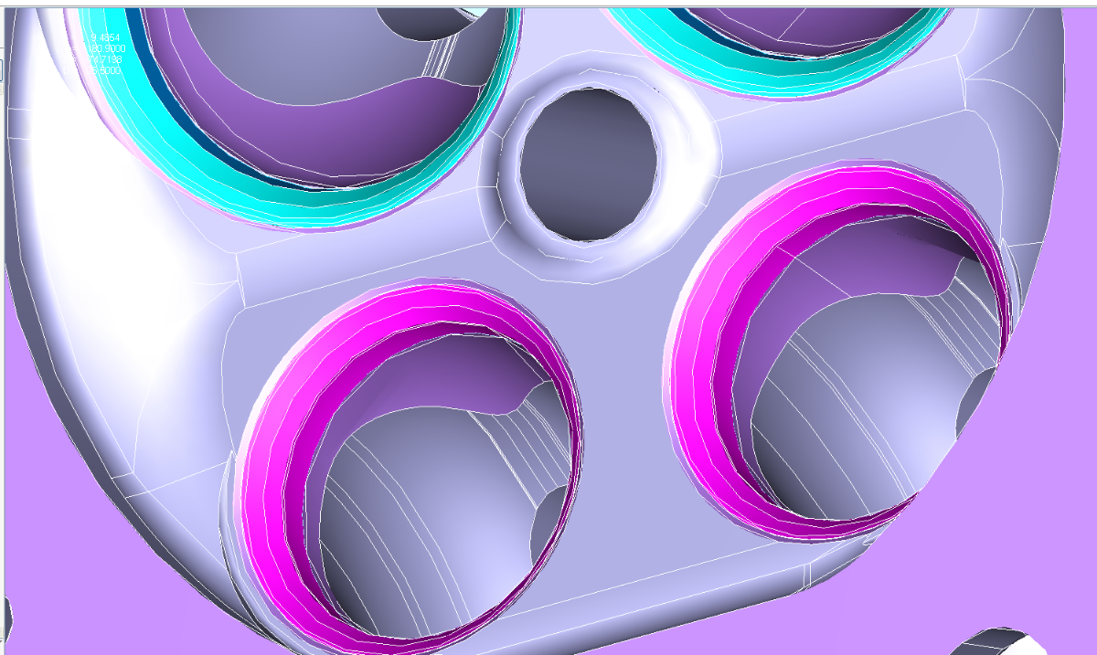

[Pa...] Posted February 13 Share Posted February 13 My auto-mechanics never really merged well with my measurement geek side. Can you share a drawing snippet? How much off location are you likely to see? There's probably a material detection or self-centering solution. Link to comment https://qualityforum.zeiss.com/topic/25829-cylinder-head-seats-and-guides/#findComment-146169 Share on other sites More sharing options...
[Cl...] Posted February 13 Share Posted February 13 Do you have a CAD model? What does the geometry extract as? Link to comment https://qualityforum.zeiss.com/topic/25829-cylinder-head-seats-and-guides/#findComment-146187 Share on other sites More sharing options...

[Da...] Posted February 19 Author Share Posted February 19 This is not the same model, but the idea is the same. Basically we need to measure the 'seat' as a cone and generate the angle, runout back to the guides and depth. Usually there is no problem, but if I come off the fire face and the depth is not the same every time I might find the issue with 'finding' the seat. It will measure the cone in not exactly the same position every time. Link to comment https://qualityforum.zeiss.com/topic/25829-cylinder-head-seats-and-guides/#findComment-146421 Share on other sites More sharing options...
[Ri...] Posted February 19 Share Posted February 19 When I programmed the heads for Cummins, I used two circle scans and 4 lines scans. I had no problem reporting runout to the valve guides; it went thru a full MSA at Cummins. One thing we did, was not to use the entire surface of the Head as a Datum, it had too much form variation. Their engineers went with three Datum targets to stabilize the head surface. 1 Link to comment https://qualityforum.zeiss.com/topic/25829-cylinder-head-seats-and-guides/#findComment-146439 Share on other sites More sharing options...
[Pa...] Posted February 20 Share Posted February 20 You could certainly poke in there with a self-center point and a big stylus tip, evaluate as midpoint, and take the (x,y, and / or Z) of that point to execute a suitable probing. Link to comment https://qualityforum.zeiss.com/topic/25829-cylinder-head-seats-and-guides/#findComment-146515 Share on other sites More sharing options...
