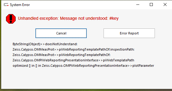

[Qu...] Posted February 12 Share Posted February 12 Does anybody know how to fix this error code. I cannot open plot in the programing page, but the plot does show up on the report. Link to comment Share on other sites More sharing options...
[Ri...] Posted February 19 Share Posted February 19 It appears the template doesn't exist in the required search path. This typically happens when a template is renamed or not copied to corresponding CMM file folder structure. Perhaps it was created on one system, program copied to another system and the template is not available. Link to comment Share on other sites More sharing options...
[Ma...] Posted February 23 Share Posted February 23 Hi, this could be caused by the following: This error occurs after incorrectly copying the configuration and can be resolved as follows: Open the values file in the following directory with a text editor: C:\Users\Public\Documents\Zeiss\CALYPSO 8.0\config\env Search for the following term: piWebPreviewTemplate Replace the highlighted section between the first and last brackets with the following method: -> #piWebPreviewTemplate -> (UI.OMCarefulValueHolder with: (#system -> 'PlotProtocol.ptx')) Best Regards Marcel 1 Link to comment Share on other sites More sharing options...
