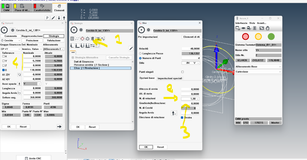

[Fe...] Posted February 16 Share Posted February 16 Please sign in to view this username. "I am not sure if this is the correct strategy, but try taking 4 points to create a circle. Then, from the strategy menu, create a helical path and enter the thread pitch in the 'gradients' field and the number of revolutions. You can change the axis distances in the element's main window (x; y; z)." Link to comment https://qualityforum.zeiss.com/topic/25843-how-to-make-od-thread-a-datum/#findComment-146229 Share on other sites More sharing options...
