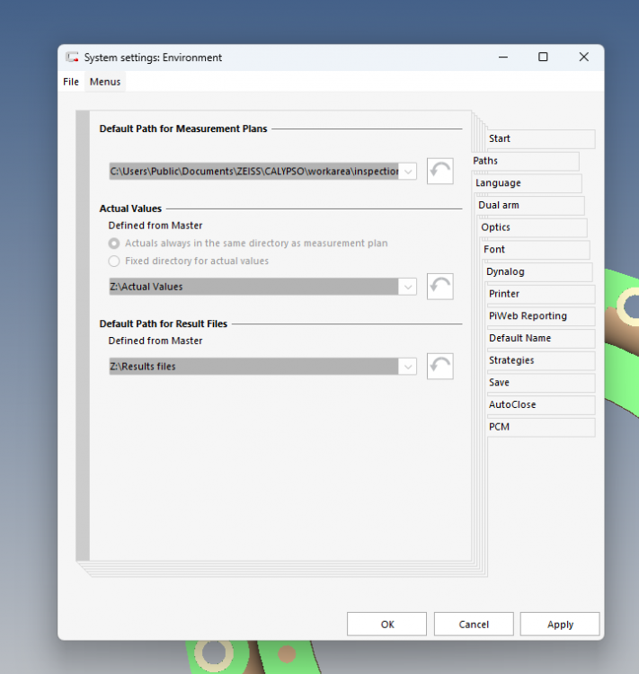

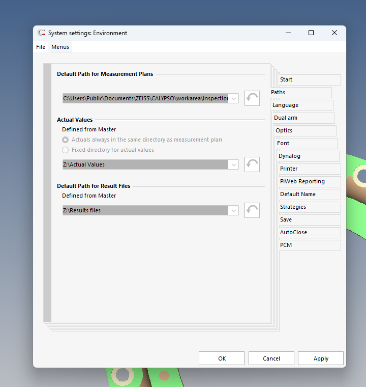

[Pa...] Posted February 13 Share Posted February 13 I've been through this but not for a long time. Best I could come up with was the following: Excel report outputs are handled as "results files" and thereby will be stored wherever results files are pointed - Extras/settings/environment/paths *can only be changed by the Master account* I was unable to isolate Excel outputs from other "results files" so it's not a complete solution. Link to comment https://qualityforum.zeiss.com/topic/25851-program-specific-results-folder-location/#findComment-146163 Share on other sites More sharing options...
[Jo...] Posted February 13 Author Share Posted February 13 Please sign in to view this quote. Appreciate the response. Unfortunately, this is the "global" method I mentioned in the OP. I am looking to change this location for an individual program. This can likely be done with PCM in the post setting, I just don't know the best method to proceed. Link to comment https://qualityforum.zeiss.com/topic/25851-program-specific-results-folder-location/#findComment-146171 Share on other sites More sharing options...

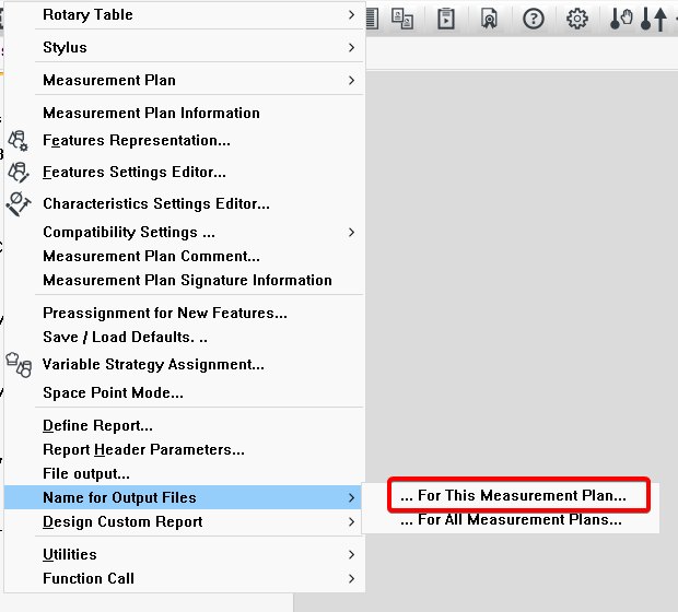

[Lu...] Posted February 13 Share Posted February 13 Hi Joseph, Have you tried Resources > Name for Output Files > For This Measurement Plan? With this function, you can specify the folder in which your results output to. This KB article explains in more detail - https://portal.zeiss.com/knowledge-base?id=587888. Link to comment https://qualityforum.zeiss.com/topic/25851-program-specific-results-folder-location/#findComment-146175 Share on other sites More sharing options...

[Lu...] Posted February 13 Share Posted February 13 Please sign in to view this quote. I'm sorry, I missed the EXCEL file clarification. This would not apply to those. Link to comment https://qualityforum.zeiss.com/topic/25851-program-specific-results-folder-location/#findComment-146179 Share on other sites More sharing options...

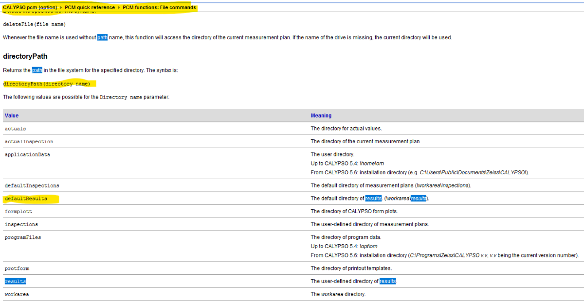

[Jo...] Posted February 13 Author Share Posted February 13 Please sign in to view this quote. Yeah, this is something I might mess around with. I was looking at a PCM option, but am not getting the Syntax correct, keep getting errors. I found the section below in the help menu. Any PCM gurus able to help? Link to comment https://qualityforum.zeiss.com/topic/25851-program-specific-results-folder-location/#findComment-146183 Share on other sites More sharing options...

[Je...] Posted February 14 Share Posted February 14 In your inspection_start_pcm.txt, to get the actual partnumber incemental, because it changes after calculation: vPNb=getRecordHead("partnbinc") in your calculation_end_pcm.txt: vXLSfile=getRecordHead("planid")+"_"+vPNb+".xls" vXLSpath="C:\Users\Public\Documents\Zeiss\CALYPSO\workarea\results\"+vXLSfile vCOPYfile="yourFilename.xls" //or vXLSfile vCOPYpath="yourCopypath\"+vCOPYFile copyFile(vXLSpath,vCOPYpath) deleteFile(vXLSpath) //if you want to delete origin 1 Link to comment https://qualityforum.zeiss.com/topic/25851-program-specific-results-folder-location/#findComment-146193 Share on other sites More sharing options...
[Ra...] Posted February 16 Share Posted February 16 filePathExcel = directoryPath("results") + "\" + getRecordHead("planid") + "_" + getRecordHead("partnbinc") + ".xls" scriptPath = "Wscript " + directoryPath("results") + "\deleteFile.vbs" newFolder="C:\Temp\" + getRecordHead("planid") + "_" + getRecordHead("partnbinc") + ".xls" //wait(10) //if the file is not copying, uncomment this delay to give it more time if fileExists(filePathExcel) then copyFile(filePathExcel,newFolder) deleteFile(directoryPath("results") + "\temp.txt") addToFile(directoryPath("results") + "\temp.txt", filePathExcel) systemCallWithWait(scriptPath) endif From this knowledge base article. https://portal.zeiss.com/knowledge-base?id=722231 1 1 Link to comment https://qualityforum.zeiss.com/topic/25851-program-specific-results-folder-location/#findComment-146213 Share on other sites More sharing options...
