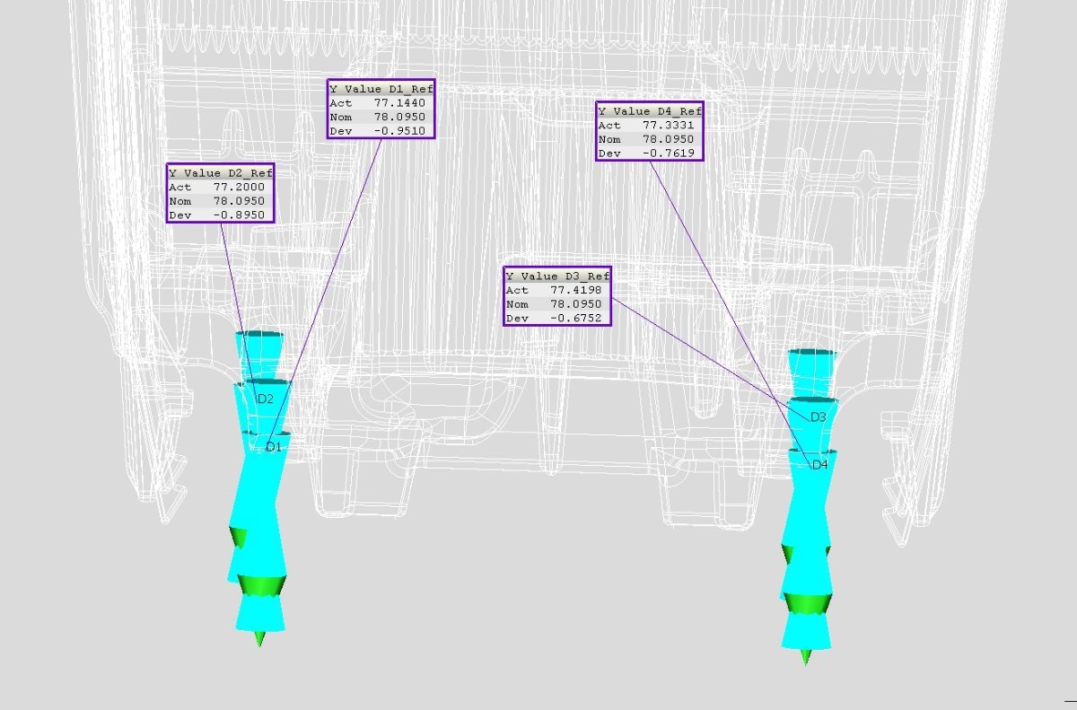

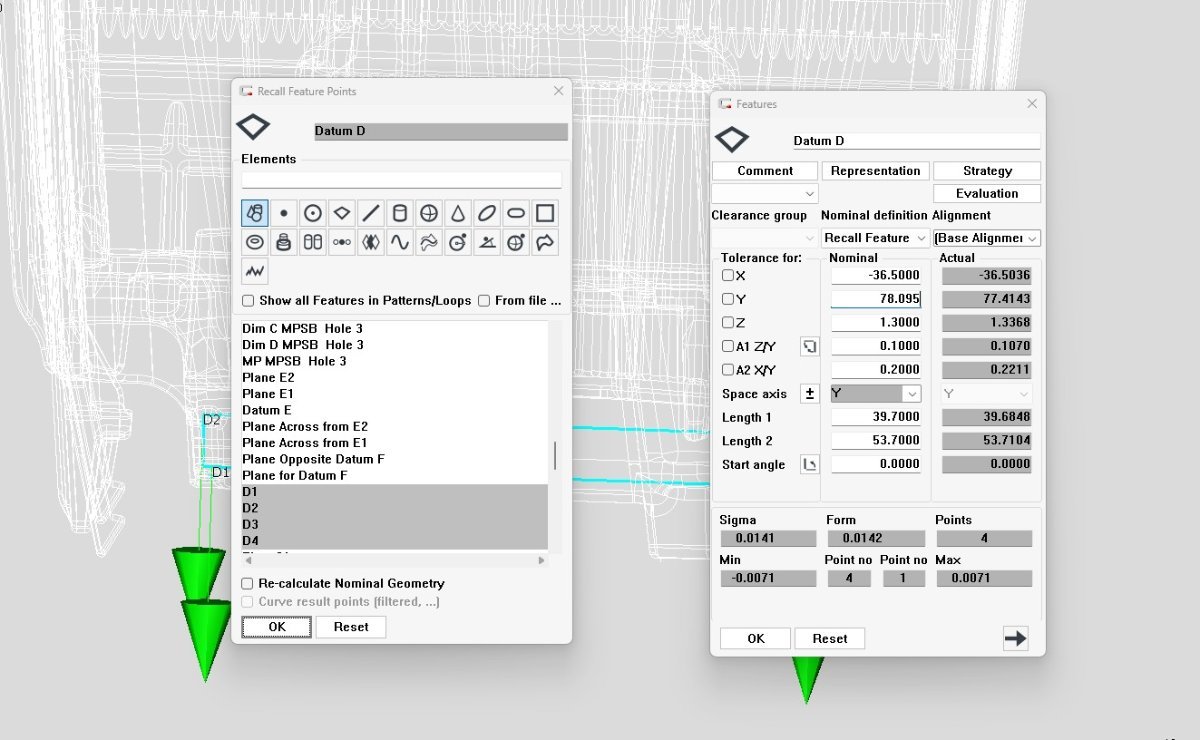

[Ma...] Posted February 16 Share Posted February 16 I have to recall 4 Datum Targets into a plane, nominally at the same height but in this case they are over .250mm different, I took all the Y value as this plane was constructed in Y and averaged them but that is not the number I am getting for the Y value of my plane and I can't find any explanation as too how this is being calculated, anyone have any insight? Link to comment https://qualityforum.zeiss.com/topic/25863-recalling-feature-points-into-a-plane-calculation/ Share on other sites More sharing options...
[Ri...] Posted February 16 Share Posted February 16 Use Recall instead of Recall Feature Points. I believe your issue is going to be in your nominals - mainly look at how it says your nominal A1/A2 is tilted. Link to comment https://qualityforum.zeiss.com/topic/25863-recalling-feature-points-into-a-plane-calculation/#findComment-146247 Share on other sites More sharing options...
[Ca...] Posted February 24 Share Posted February 24 Yes, the angle is going to throw off where that Y value is. The Y value will come from the origin of the plane feature, it wont necessarily be on any one of those points or an average of all of those points. With the feature window open, you will see a light tetrahedron. This will show you where that Y value is calculating. Because there is an angle on the plane, that may be above or below where you calculate the average since it will be in the corner of the plane rather than the center. 1 Link to comment https://qualityforum.zeiss.com/topic/25863-recalling-feature-points-into-a-plane-calculation/#findComment-146675 Share on other sites More sharing options...
