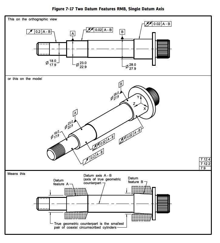

[To...] Posted February 26 Share Posted February 26 Below is a clip from ASME Y14-5.2024 regarding 2 inline datum features. Does ISO or DIN interpret this in the same manner? Link to comment https://qualityforum.zeiss.com/topic/25963-asme-vs-iso/ Share on other sites More sharing options...
