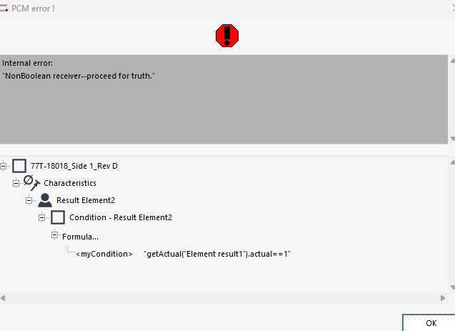

[Qu...] Posted March 6 Share Posted March 6 Hello everyone, Im trying to create a system where reports will be sorted into Passed(no OOT measurement) and Failed( 1 or more OOT measurement). This then will dictate where the report will be save into 2 separate folders. Based on what I research online, it seems doable. I think it might require PCM (I am planning to purchase) and maybe Piweb enterprise. The goal is to be able to sort through the data quickly or even import it directly into a report. If anyone have an idea please help me out. Thank you! Link to comment https://qualityforum.zeiss.com/topic/26059-creating-a-passedfailed-reporting-folders/ Share on other sites More sharing options...

[Qu...] Posted March 7 Author Share Posted March 7 Hi Martin, Thank you for showing me this. Can you help clarify it a bit further. This will display an iO and niO in the name of the pdf generated correct?, Also, this showed up when I try running the program. Link to comment https://qualityforum.zeiss.com/topic/26059-creating-a-passedfailed-reporting-folders/#findComment-147341 Share on other sites More sharing options...
[Ma...] Posted March 7 Share Posted March 7 OK, so what i see is you need 1x Result element with this formula and disabled tolerances ( name "ElementResult1" ) Please sign in to view this quote. It will produce "1" or "0". Now 1x Result element for setting "iO" with this formula ( name "ElementResult-iO" ) Please sign in to view this quote. Apply this condition Please sign in to view this quote. Now 1x Result element for setting "NiO" with this formula ( name "ElementResult-NiO" ) Please sign in to view this quote. And this condition Please sign in to view this quote. I won't be able to help further - i will be whole week outside Calypso 1 Link to comment https://qualityforum.zeiss.com/topic/26059-creating-a-passedfailed-reporting-folders/#findComment-147343 Share on other sites More sharing options...

[Qu...] Posted March 9 Author Share Posted March 9 Got it to work! Thank you! When you have the time, can you explain why we have to change the name to Elementresult? Link to comment https://qualityforum.zeiss.com/topic/26059-creating-a-passedfailed-reporting-folders/#findComment-147389 Share on other sites More sharing options...
[Ma...] Posted March 9 Share Posted March 9 Please sign in to view this quote. You don't have to rename it - i have written it like this to keep names in conditions the same as name of that Result element. You an rename it as you want. Just remember that this name is used in conditions. Link to comment https://qualityforum.zeiss.com/topic/26059-creating-a-passedfailed-reporting-folders/#findComment-147409 Share on other sites More sharing options...
