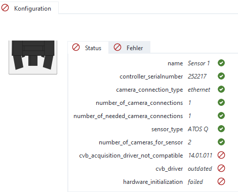

[Jo...] Posted March 12 Share Posted March 12 Hello, i just updated the cvb aquisition driver through the quality suite and now i can`t connect my sensor. How can is solve this? Update the "cvb_driver"? Link to comment https://qualityforum.zeiss.com/topic/26109-how-to-update-atosq-cvb_driver/ Share on other sites More sharing options...
[Jo...] Posted March 12 Author Share Posted March 12 I "solved" the problem for the moment by downgrading the aquisition driver to version 14.1.6. Link to comment https://qualityforum.zeiss.com/topic/26109-how-to-update-atosq-cvb_driver/#findComment-147633 Share on other sites More sharing options...
[Jo...] Posted March 12 Author Share Posted March 12 Seems like this is a mix up with the 2026 Version of Zeiss Inspect. After Updating to Zeiss Inspect 2026 i had to use the new driver and could update the firmware of the sensor. Would have been nice not to get an update under Zeiss Inspect 2025 that only works with zeiss inspect 2026 🙂 1 Link to comment https://qualityforum.zeiss.com/topic/26109-how-to-update-atosq-cvb_driver/#findComment-147653 Share on other sites More sharing options...
