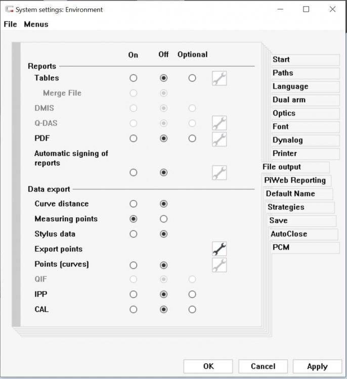

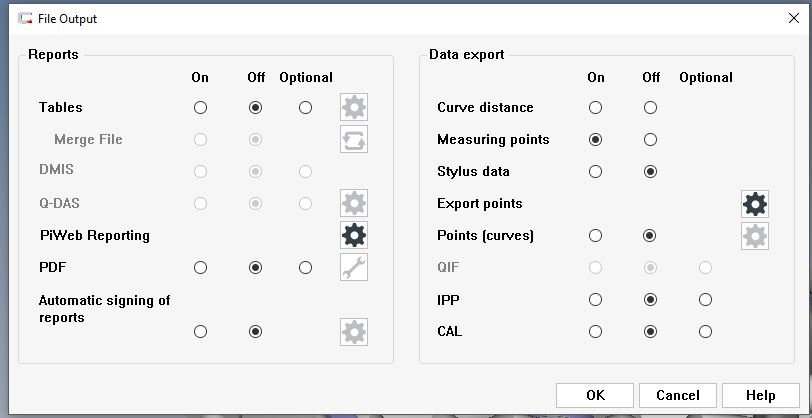

[Da...] Posted March 17 Share Posted March 17 Hi All, Currently running Calypso 2025. I've enabled automatic data export of Measuring Points, however I was wondering if limiting the amount of measured points is in a different location? I know in previous versions it was right next to it. I've attached an image of the options I have under the Resources > File Output... menu. Any help is appreciated. Thank you Link to comment https://qualityforum.zeiss.com/topic/26151-measuring-points-limit/ Share on other sites More sharing options...
[Sv...] Posted March 17 Share Posted March 17 Since 2025, this setting can also be found globally in the settings. Perhaps the limit is also located there. I can't check at the moment. Link to comment https://qualityforum.zeiss.com/topic/26151-measuring-points-limit/#findComment-147853 Share on other sites More sharing options...
[Ri...] Posted March 17 Share Posted March 17 I believe the limit has been completely removed. It is either on or off now. Link to comment https://qualityforum.zeiss.com/topic/26151-measuring-points-limit/#findComment-147881 Share on other sites More sharing options...

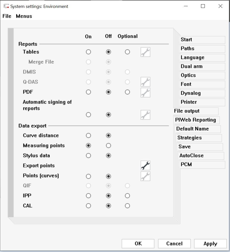

[Da...] Posted March 18 Author Share Posted March 18 Please sign in to view this quote. Thank you for the response. Tried checking in the settings but unfortunately its the same, no limit field. Link to comment https://qualityforum.zeiss.com/topic/26151-measuring-points-limit/#findComment-147927 Share on other sites More sharing options...
[Da...] Posted March 18 Author Share Posted March 18 Please sign in to view this quote. Thank you for the response. I believe you're correct. We'll just have to manually delete the files over time. Link to comment https://qualityforum.zeiss.com/topic/26151-measuring-points-limit/#findComment-147929 Share on other sites More sharing options...
