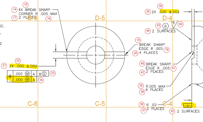

[To...] Posted March 26 Share Posted March 26 Hello all, I have a call out of 0 tolerance true position of a slot to datum A plane, which I just do not understand how to go about creating in calypso. I'm fairly new to the software and this call out has never crossed my path on any print. I would certainly appreciate any information that would help me Thanks, Tom Prophet Link to comment https://qualityforum.zeiss.com/topic/26228-0-tolerance-true-position/ Share on other sites More sharing options...
[Ma...] Posted March 26 Share Posted March 26 I will help with understanding of 0 tol. You have to use symmetry point or symmetry plane - not symmetry in construction menu. Then with MMC you can gain max .004 bonus tolerance. So if you have the smallest groove, you have to be precise. If you have the biggest groove you can be misaligned. So on .052 you have .004 tolerance On .048 you have 0 tolerance. 3 Link to comment https://qualityforum.zeiss.com/topic/26228-0-tolerance-true-position/#findComment-148290 Share on other sites More sharing options...
[Ze...] Posted March 26 Share Posted March 26 The second tier is only controlling perpendicularity to -A- so you would need to measure the slot sides as planes to fulfill the print requirement. 😲 Link to comment https://qualityforum.zeiss.com/topic/26228-0-tolerance-true-position/#findComment-148294 Share on other sites More sharing options...
[Ri...] Posted March 26 Share Posted March 26 It's a pattern, so they have to control their position/orientation with respect to themselves. Link to comment https://qualityforum.zeiss.com/topic/26228-0-tolerance-true-position/#findComment-148296 Share on other sites More sharing options...
[Ze...] Posted March 26 Share Posted March 26 You are correct. For whatever reason I was looking at it as a continuous feature. You would still need to measure it as planes, correct? Link to comment https://qualityforum.zeiss.com/topic/26228-0-tolerance-true-position/#findComment-148316 Share on other sites More sharing options...
[Ri...] Posted March 26 Share Posted March 26 I mean "technically" you should, but given that it is only .020" deep that might pose to be a challenge. 1 Link to comment https://qualityforum.zeiss.com/topic/26228-0-tolerance-true-position/#findComment-148318 Share on other sites More sharing options...
[na...] Posted March 27 Share Posted March 27 Please sign in to view this quote. Please sign in to view this quote. I'm interested, isn't it the same thing in this case - pattern or continuous feture? Link to comment https://qualityforum.zeiss.com/topic/26228-0-tolerance-true-position/#findComment-148324 Share on other sites More sharing options...
[Ri...] Posted March 27 Share Posted March 27 I don't think so. The Position of a CF to A would just be the orientation of the symmetric plane to A (Perpendicularity), but the Position of a 2x pattern to A would be each of their orientations to A (Perpendicularity) as well as their respective orientation and location to each other. 1 1 Link to comment https://qualityforum.zeiss.com/topic/26228-0-tolerance-true-position/#findComment-148336 Share on other sites More sharing options...

[To...] Posted April 2 Author Share Posted April 2 Just in case you're still viewing this thread, how would I go about measuring this in calypso? I basically understand what you're implying I'm just not sure how to go about measuring it. Link to comment https://qualityforum.zeiss.com/topic/26228-0-tolerance-true-position/#findComment-148610 Share on other sites More sharing options...
