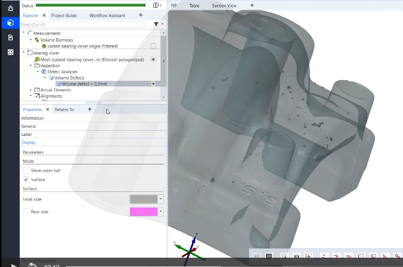

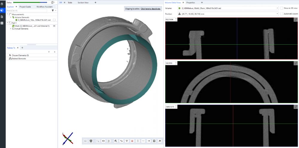

[MO...] Posted February 12, 2023 Share Posted February 12, 2023 Please help, I imported a CT scan volume data , polygonizing shows as surface data and not as a solid volume. What am i doing wrong? Thank you in advance. Link to comment https://qualityforum.zeiss.com/topic/2624-ct-scan-volume-scan-data-appears-as-surfaces/ Share on other sites More sharing options...
[Je...] Posted February 13, 2023 Share Posted February 13, 2023 Hello Mol, this is normal, did you experiance/expect other results? Best regards, Jens Braun Link to comment https://qualityforum.zeiss.com/topic/2624-ct-scan-volume-scan-data-appears-as-surfaces/#findComment-6846 Share on other sites More sharing options...
[Ja...] Posted February 15, 2023 Share Posted February 15, 2023 Please sign in to view this username. i would guess the expectation from Please sign in to view this username. was that the resultant mesh would be solid as per the real material. Link to comment https://qualityforum.zeiss.com/topic/2624-ct-scan-volume-scan-data-appears-as-surfaces/#findComment-6886 Share on other sites More sharing options...
[MO...] Posted February 21, 2023 Author Share Posted February 21, 2023 Hello Please sign in to view this username. , thank you Please sign in to view this username. that was my expectation. I was expecting a solid so that I can carry out volume inspection for porosity as in the image. So I still don't know what I am doing wrong that I am unable to get a solid for porosity inspection. I did create volume defect element from mesh and I still did not find a solid like in the image below and the coloured legend did appear on the image either. Could you please help me. Thank you in advance. Link to comment https://qualityforum.zeiss.com/topic/2624-ct-scan-volume-scan-data-appears-as-surfaces/#findComment-6944 Share on other sites More sharing options...
[Ja...] Posted February 22, 2023 Share Posted February 22, 2023 the volume of the mesh nor the porosity calculation requires a solid mesh model . the software is looking at the normals of the surfaces of the mesh to generate the enclosed volume . it maybe that you are being thrown by the semi transparent visualisation of the mesh in this image ? Link to comment https://qualityforum.zeiss.com/topic/2624-ct-scan-volume-scan-data-appears-as-surfaces/#findComment-6963 Share on other sites More sharing options...
