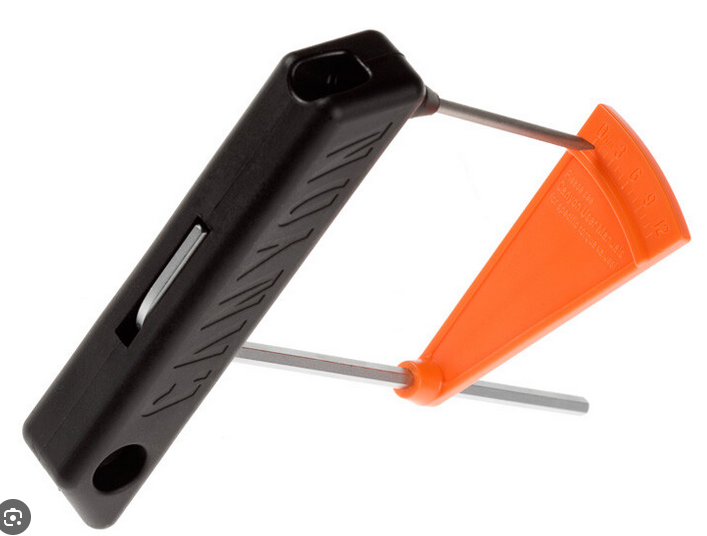

I was introduced to these by my mentor back in 2000. It's a feel type, i have used the same way he showed me since. I haven't had any problems with any stripping out on me or too loose. My calibrations have all been good too after changing. I guess i have been lucky with this.
