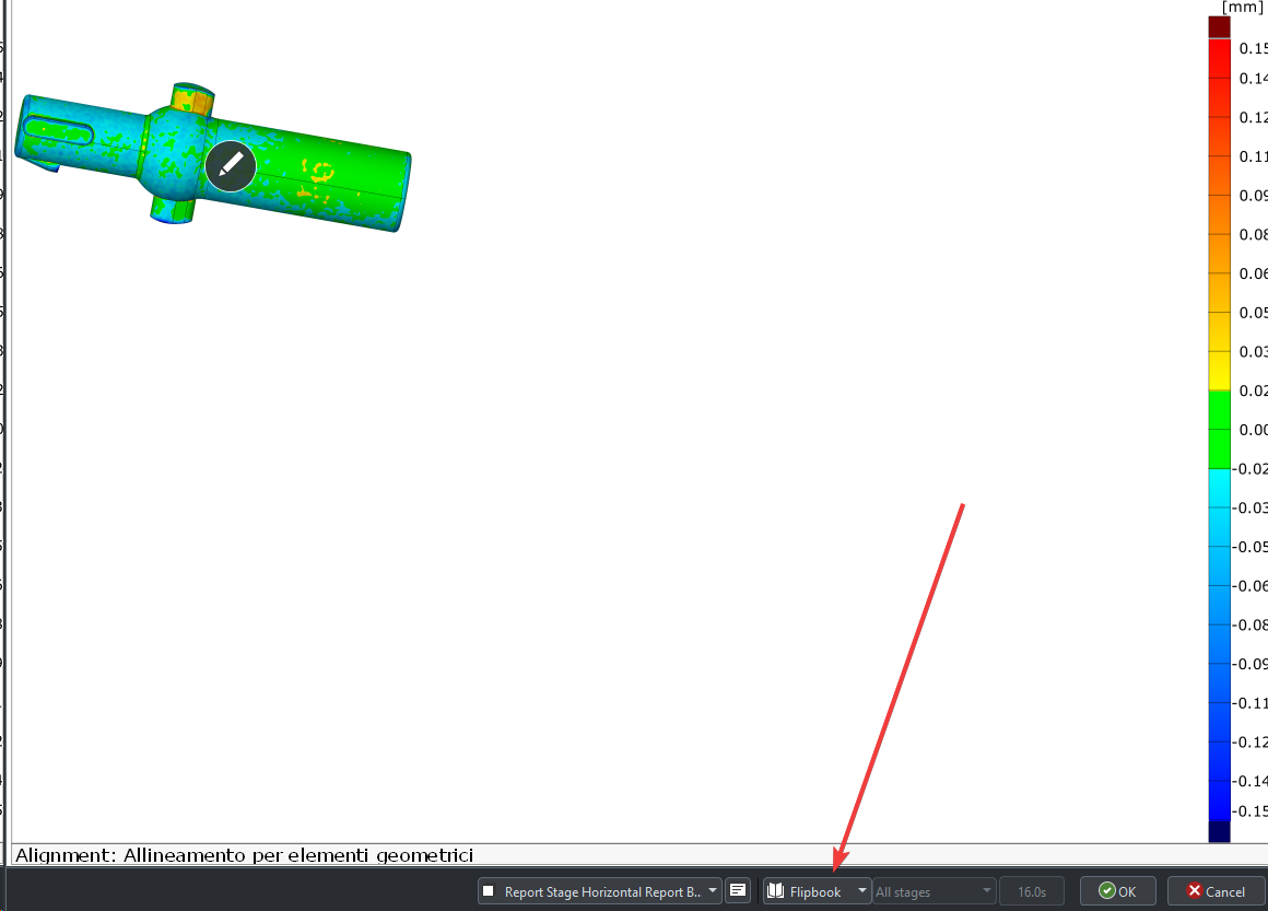

[Ma...] Posted April 1 Share Posted April 1 Is there a way to convert a single page to a flipbook? Link to comment https://qualityforum.zeiss.com/topic/26274-convert-a-single-report-page-to-a-flipbook/ Share on other sites More sharing options...
[DW...] Posted April 1 Share Posted April 1 Please sign in to view this username. What is a flipbook? Link to comment https://qualityforum.zeiss.com/topic/26274-convert-a-single-report-page-to-a-flipbook/#findComment-148526 Share on other sites More sharing options...
[Ma...] Posted April 1 Author Share Posted April 1 When you take a new image to do a report page there is a flipbook option to choose: this is indipendent from how many cavities you have. If you make a template with 8 cavities and, instead of a normal page, you have a flipbook and you put in the template 6 cavities and update the report, you have automatically the report for the 6 cavities and you don't have to remove manually 2 pages. I hope I explained myself. 1 Link to comment https://qualityforum.zeiss.com/topic/26274-convert-a-single-report-page-to-a-flipbook/#findComment-148528 Share on other sites More sharing options...
[Na...] Posted April 1 Share Posted April 1 Hi Marco, the command seems to be recorded in the create command of a report page, but not in the edit report page. I think you need to restore view from the report page you want to change to flipbook, then create report page with flipbook = true in the parameters. Correction: It works when the Right click -> Reconfigure Report Page command is used. You can add the flipbook = True to the parameters: gom.script.report.update_report_page ( pages=[gom.app.project.reports['report 1']], used_alignments='current', used_digits='report', used_legends='current', used_stages='current', used_units='report', flipbook=True) 2 Link to comment https://qualityforum.zeiss.com/topic/26274-convert-a-single-report-page-to-a-flipbook/#findComment-148530 Share on other sites More sharing options...

[De...] Posted April 17 Share Posted April 17 Please sign in to view this username. you can also change from single stage to video/flipbook in the properties of the report page: 1 Link to comment https://qualityforum.zeiss.com/topic/26274-convert-a-single-report-page-to-a-flipbook/#findComment-149264 Share on other sites More sharing options...
