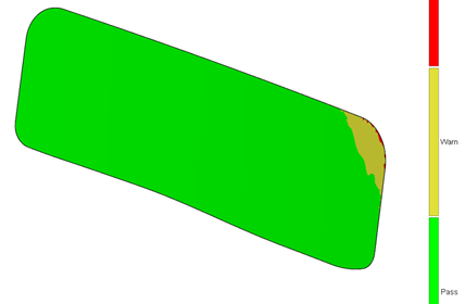

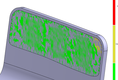

[Da...] Posted June 10, 2021 Share Posted June 10, 2021 (edited) We have exact patches in CAD that show contact surfaces to other parts, and they have specific tolerance. These are separate from the part CAD. In effect at the contact surfaces there are two layers of CAD occupying the same space. We can evaluate this perfectly, but when we show the part, its visualization gets confused with the CAD model. Is there any way I can show the evaluation of the patches, and the CAD model without cutting the CAD apart? Images below, the bottom one is the issue. Edited June 10, 2021 Removing part# from image Link to comment https://qualityforum.zeiss.com/topic/263-color-map-visualization/ Share on other sites More sharing options...
[An...] Posted June 12, 2021 Share Posted June 12, 2021 Hallo David, perhaps it would be helpful to provide the entire CAD data with transparency, or only the CAD data of the specific patch? Or to show only the boundary curves of the CAD data and not the CAD surfaces? Link to comment https://qualityforum.zeiss.com/topic/263-color-map-visualization/#findComment-750 Share on other sites More sharing options...
[Be...] Posted June 14, 2021 Share Posted June 14, 2021 Hi, do not include the contact CAD into your surface comparison. Only selected visible patches are used for creation. Of course the default is to select all CADs but you can modify it. For the part workflow you have to separate these CADs into different parts or you have to work with PatchCompounds which you have to create from the CAD. Does this help? Regards, Bernd Link to comment https://qualityforum.zeiss.com/topic/263-color-map-visualization/#findComment-756 Share on other sites More sharing options...
[Da...] Posted June 16, 2021 Author Share Posted June 16, 2021 Thanks, the transparency thing I've done, it looks OK. The best thing is to just cut the CAD so it's only one layer, it looks the best, but takes some time. Patches, and the contact surfaces aren't the same.. would be nice.. Link to comment https://qualityforum.zeiss.com/topic/263-color-map-visualization/#findComment-775 Share on other sites More sharing options...
