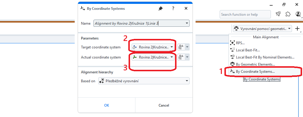

Hi, thanks for your reply! This is my first time using inspection software, so I don't understand everything yet, haha.
The measurement principles are set up, and I can create my datum points, but I can't seem to get the results I want. Specifically, I need to compare a surface profile against a reference system. As you can see in the photo, I can check the surface profile without a reference, but once I have my reference point, the surface profile function in the GD&T Quick Creation menu no longer appears.
I have something more to do ? Maybe my datum points are not right ?

Well what i am used to do is making datum system from "Construct -> Local coordinate system -> Create Datum System" and "Create Datum System (nominal)"
You have more options there, but you have to do nominal and then the same without "nominal" - this will create blue and green alignment, which can be then used in Main alignment and as datums for profiles and so on.
Also you can do basic with "Construct -> Local coordinate system -> By Geometric Elements" - fill out elements - what goes first it takes whatever freedom it can
Now you can define mesuring principle ( Refferenced contruction ).
Now do as in this screen
