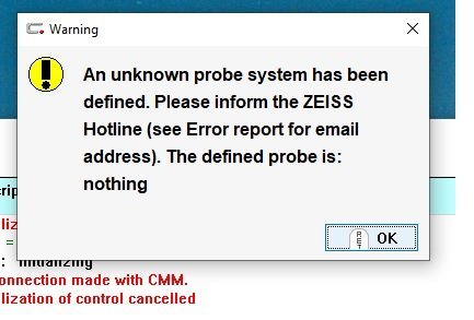

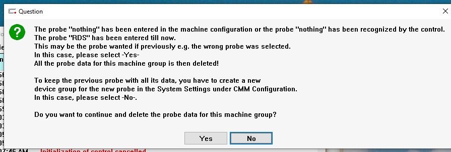

[Ra...] Posted April 13 Share Posted April 13 This happened last year. I had to call technical support. Link to comment https://qualityforum.zeiss.com/topic/26352-please-help-the-probe-nothing-has-been-entered-in-the-machine-configuration-or-the-probe-nothing-has-been-recognized-by-the-control/ Share on other sites More sharing options...
[Ja...] Posted April 13 Share Posted April 13 That might be the same problem I had posted about a while ago. Link to comment https://qualityforum.zeiss.com/topic/26352-please-help-the-probe-nothing-has-been-entered-in-the-machine-configuration-or-the-probe-nothing-has-been-recognized-by-the-control/#findComment-149000 Share on other sites More sharing options...
[Or...] Posted April 17 Share Posted April 17 We had one of our Conturas have this error just a few weeks ago. We had a tech come out and he diagnosed the problem as a malfunctioning sensor control board. After it was replaced, our machine was fixed. Hope this helps. 1 Link to comment https://qualityforum.zeiss.com/topic/26352-please-help-the-probe-nothing-has-been-entered-in-the-machine-configuration-or-the-probe-nothing-has-been-recognized-by-the-control/#findComment-149262 Share on other sites More sharing options...
