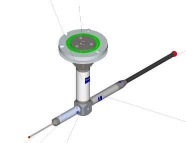

[Ra...] Posted April 13 Share Posted April 13 First time I've ever seen something like that. I would probably just keep taking off components one by one to try and isolate the problem child. One stylus off, other stylus off, knuckle off, etc. If it keeps alarming when completely dissasembled, maybe it has something to do with the qualification? Very shocked that changing the adapter plate and rack port didn't help. 1 Link to comment https://qualityforum.zeiss.com/topic/26356-probe-storing-problem/#findComment-148994 Share on other sites More sharing options...
[To...] Posted April 14 Author Share Posted April 14 Another funny thing. It seems like each time I change something, it will actually work ONCE but then doesn't work again. I am getting a complex that there's a hidden camera somewhere and someone is messin' with me. 1 Link to comment https://qualityforum.zeiss.com/topic/26356-probe-storing-problem/#findComment-149028 Share on other sites More sharing options...
[Ni...] Posted April 14 Share Posted April 14 Do you have another machine you could try this on? Rule out the probe head if it is a weight or balance issue? I had this issue once but it was specific to the holder location. It ended up being that the screw somehow backed out that held in the circular clocking tab that is under the bellow of the holder. 1 Link to comment https://qualityforum.zeiss.com/topic/26356-probe-storing-problem/#findComment-149030 Share on other sites More sharing options...

[Ni...] Posted April 14 Share Posted April 14 Can you add a short extension in the Z axis? is there a chance its hitting the bottom of the holder on the way in? 1 Link to comment https://qualityforum.zeiss.com/topic/26356-probe-storing-problem/#findComment-149034 Share on other sites More sharing options...
[To...] Posted April 14 Author Share Posted April 14 (edited) Please sign in to view this username. That was my original config and it didn't work after a couple of probe changes. The only other thing that I can't try is swapping the VAST-Gold sensor, which was replaced back in December. Edited April 14 Link to comment https://qualityforum.zeiss.com/topic/26356-probe-storing-problem/#findComment-149090 Share on other sites More sharing options...

[Ch...] Posted April 15 Share Posted April 15 I agree that its odd that changing adaptor plates or probe holders didn't help. I don't think balance is your issue. I use one stylus system that is way more out of balance than that one, and it still picks up and drops off fine. Gremlins or Voodoo is the only logical explanation here. 2 Link to comment https://qualityforum.zeiss.com/topic/26356-probe-storing-problem/#findComment-149126 Share on other sites More sharing options...

[To...] Posted April 15 Author Share Posted April 15 Everything is official Zeiss gear. I will take a look at plastic buildup, including on the other two adapter plates. This machine is not in a production environment and gets very light usage. It is off more than it is on. I'm going to focus on the balance though I've used unbalanced stylus systems in the part and never had an issue. I do try to use some kind of counterweight most of the time. Everything I'm currently using is carbon fiber with the exception of the 3x58 stylus with the steel extensions. Maybe the steel extensions are too much weight in the -Y direction.... Any suggestions on how to balance a tool? I also don't have any issues with the other probe with the extended +Y. I think the only 3 things left are the cleanliness, the balance or the new VAST-Gold, though I tech told me it couldn't be the sensor. And, the suggestions by Scott W. Thanks to everyone for the feedback. 1 Link to comment https://qualityforum.zeiss.com/topic/26356-probe-storing-problem/#findComment-149154 Share on other sites More sharing options...
