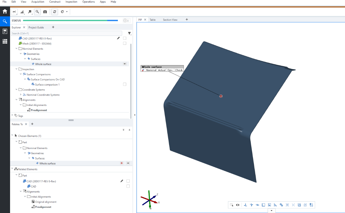

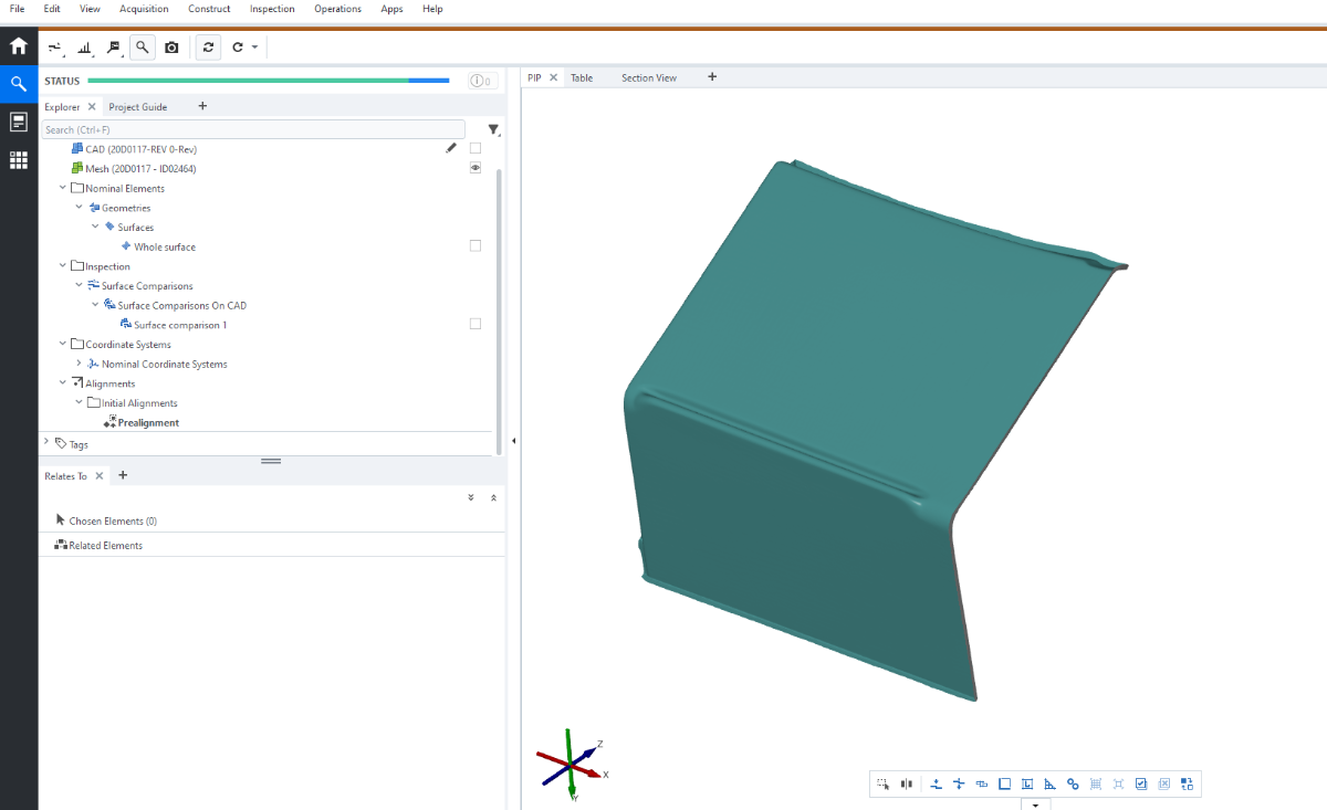

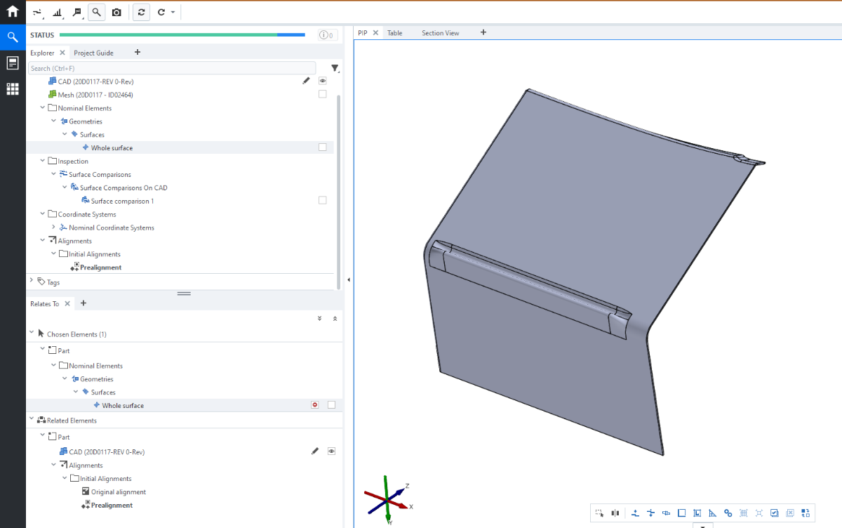

[El...] Posted April 21 Share Posted April 21 Hi everyone, Im trying to compare a surface profile (GDnT) but I have a few problems. I have to do the comparaison on the whole surface of the part (not only on one element like a plan or something else), so after the alignement, I created my reference surface on the CAD but I can't assign any measuring principle : I can't even select the mesh and 'fitting element' does not work correctly. You can see my CAD in the first pic, then my 3d scan and my nominal surface. Link to comment https://qualityforum.zeiss.com/topic/26411-advenced-measuring-principle/ Share on other sites More sharing options...
[Ma...] Posted April 21 Share Posted April 21 Due to "green" color of a surface i presume you are doing it on wrong face - in other words - on your actuals there is no surface ( it should be grey ) - green means surface viewed from inside of a material. If your scan is correct, then you have to select correct surface on model ( that side which is not viewable now ) Or your scan is not correct - missing thickness of material on actuals ( you have only a film and not thick material ) or your scan is from other machine, then you have to invert nominals. Link to comment https://qualityforum.zeiss.com/topic/26411-advenced-measuring-principle/#findComment-149391 Share on other sites More sharing options...
[El...] Posted April 22 Author Share Posted April 22 Thank you for your response ! I'm working on composite part, so my comparison are between a CAD and a 3D scan of the mold (there is no thickness). I can compare a plan if I want to do GD&T control like surface profile, but I can't do it on the entire surface if there is no thickness on my mesh ? Link to comment https://qualityforum.zeiss.com/topic/26411-advenced-measuring-principle/#findComment-149433 Share on other sites More sharing options...
[Ma...] Posted April 22 Share Posted April 22 I am not sure how Inspect is handeling situation, where you have whole model, but scan is only from a one side. You can visually compare without profile by clicking on "Compare surface on actuals" With profile and surface element i dont know 1 Link to comment https://qualityforum.zeiss.com/topic/26411-advenced-measuring-principle/#findComment-149447 Share on other sites More sharing options...
[No...] Posted April 29 Share Posted April 29 Surface profile should also work on a partial scan. But the surfaces you compare must have the same surface normal direction. So if you compare a CAD of the part with the correspondig surface of the mold, you will usually have flipped surface normals. I'm not sure if there is a switch somewhere to compensate for this. Since Inspect is capable to work with assemblies, I would assume there is one. If not, you'll possibly need to flip the normals of the scan. 1 Link to comment https://qualityforum.zeiss.com/topic/26411-advenced-measuring-principle/#findComment-149800 Share on other sites More sharing options...
