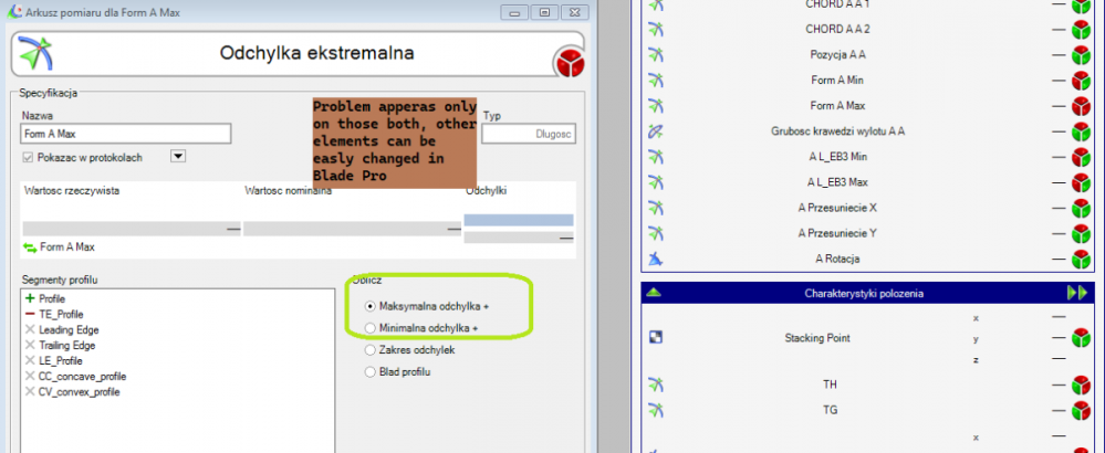

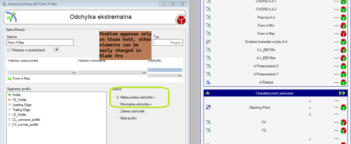

Blade Pro 2014 cannot edit some tolerances
I cannot edit some Min and Max tolerances in Blade Pro 2014
While i try to enter some new values or paste them, the value changes for "---"
On characteristisc like Chord Position or Rotation it work, i just type in and its saved.
Anybody knows what is the trick in here ?
1 like its before
2 while i edit
3 what need to change

Hi Damian,
Deviation measures have specific behaviour.
For Min and Max deviation measures the tolerances can not be set. The values are taken from the segments they are analyzed on.
It is only possible to set tolerances for average, range and profile error deviation measures.
This information can be found on the manual (F1)
Hope this helps

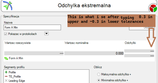

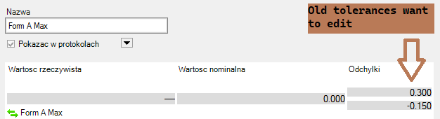

Thank you, i think i found what i shluld:
Profile tolerance is set, TE_Profile is set and i still see weird values.
Min / Max tolerances: on some sections its both having -0.15 on osome just max has -0.15
I used the update/recalculate, also accept buttons but it not helps.  Is there some special order of doing this or what ?
Hi,
The tolerance value depends on the position of the deviation measure.
As min and max are computed, their position will change for each section and measurement.
The profile has the option "Use All Profile Tolerance Segments" active. Check which segments are included and what tolerances they have defined.
Toguether with the position of the deviation measure the tolerances should give consistent values.

So tolerances are taken from two places:
1 The window where where i can select them by + - X
2 And also from segments included in "Use All Profile Tolerance Segments"
So to change final Min / Max tolerance i need to fix all this things to have tolerances as i want ?
I did it and it works, sory for maybe stupid questions, but it seems to be so weird setings to me
