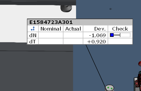

[F....] Posted April 28 Share Posted April 28 Team, I am writing a script, but I don't know where I can find variable for DT inspection value from get. Syantax. I could get act value for DN, but don't know how to get DT. Could have anyone helping? Below is what i get value for DN values["Act_Normal"] = Element.get ('result_normal.deviation') Thanks, Link to comment Share on other sites More sharing options...
[Ma...] Posted April 28 Share Posted April 28 What are you looking for? Link to comment Share on other sites More sharing options...
[F....] Posted April 28 Author Share Posted April 28 (edited) values["Act_Normal"] = Element.get ('result_normal.deviation') in my script output the value of DN, but I wanna also get DT on this point output Edited April 28 Link to comment Share on other sites More sharing options...
[F....] Posted April 28 Author Share Posted April 28 This is for GOM scripting, I am looking for the santax for Syntax like below which get DN value to get DT value. values["Act_Normal"] = Element.get ('result_normal.deviation') ## this Syntax to get measurement value from DN. Link to comment Share on other sites More sharing options...
[Ma...] Posted April 29 Share Posted April 29 I hope i found it. It should be 'result_trimming.deviation' Link to comment Share on other sites More sharing options...
[F....] Posted April 29 Author Share Posted April 29 That's wonderful! Thanks, Martin for your helping. It is works and that exceatly what I am looking for. Link to comment Share on other sites More sharing options...
