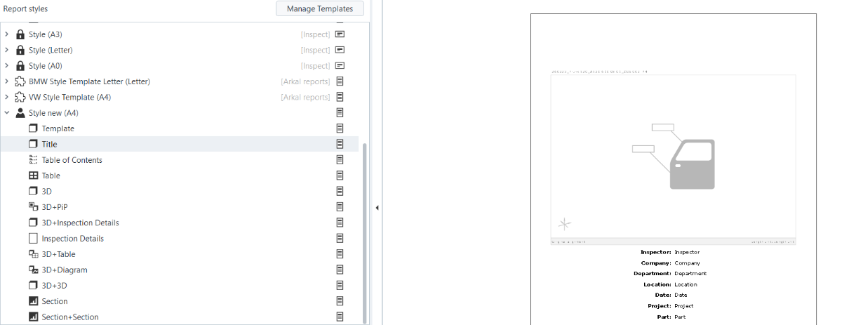

[Al...] Posted April 29 Share Posted April 29 Hello, I have created report style and dragged and dropped the respective page yet the title disappears. Am i doing something wrong or is there another way? Link to comment https://qualityforum.zeiss.com/topic/26477-create-report-style/ Share on other sites More sharing options...
[Na...] Posted April 29 Share Posted April 29 Hi, I think 3D+3D is at the wrong hierarchy: It should be inside 'Style new 1 (a4)', like 'Template'. Then it will use the master template frome Style new. If you drop 3D+3D onto the little guy symbol 'Style new 1' it should be displayed. Link to comment https://qualityforum.zeiss.com/topic/26477-create-report-style/#findComment-149787 Share on other sites More sharing options...
[Al...] Posted April 29 Author Share Posted April 29 Hi , i did what you said, but it remains the same ! (missing Report title) Link to comment https://qualityforum.zeiss.com/topic/26477-create-report-style/#findComment-149790 Share on other sites More sharing options...

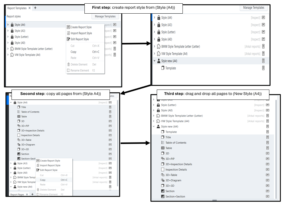

[Al...] Posted April 30 Author Share Posted April 30 Hi Karin, This is what i do: 1) Creating report style from the locked "Style (A4)" 2) copy all pages from same locked "Style (A4)" 3) drag and drop the copied pages to the "Style new (A4)". Am i doing something wrong? Link to comment https://qualityforum.zeiss.com/topic/26477-create-report-style/#findComment-149878 Share on other sites More sharing options...

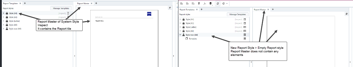

[Ka...] Posted April 30 Share Posted April 30 Create Report Style creates a new "empty" report style -> it is not based on the "Selected report style" -> usefully if you want to start from the scratch Therefor no elements are placed on the "Report Master", also no place holder for the "Report title" or the logo (see image below) So the only thing you have to do afterwards: Select the new "Report Master" and add there the place holder for the report tile and other elements that you want to have on each page later -> and you have to do this for the portrait and for landscape "Master" If you want to have everything from the locked System style and just want to modify it, you should think about using "Edit Report Style" What you choose depends on your needs, maybe take a look at https://techguide.zeiss.com/en/zeiss-inspect-2026/article/general_manage_report_style.html Link to comment https://qualityforum.zeiss.com/topic/26477-create-report-style/#findComment-149880 Share on other sites More sharing options...

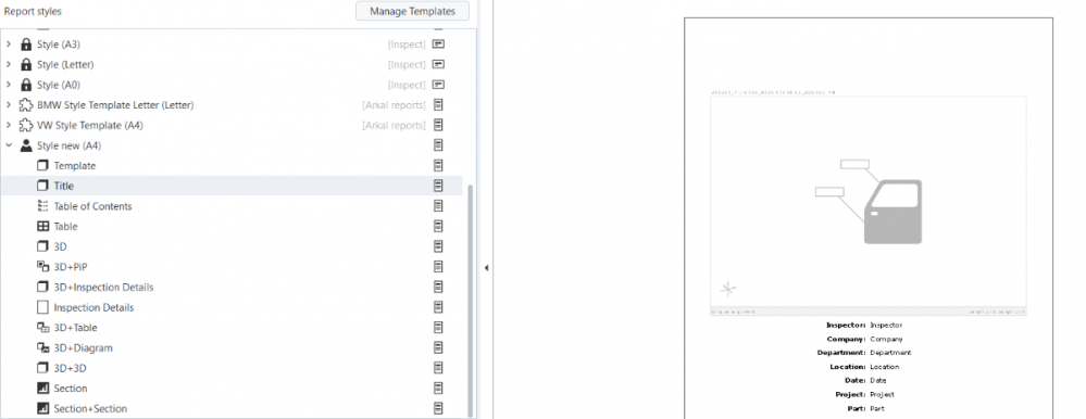

[Al...] Posted April 30 Author Share Posted April 30 This is what i do but still the title from each page does not appear. above i sent a picture of the steps i'm taking. Even if i do "Edit report style" i don't have the option to add a logo, maybe because it's locked, i don't know. If there's no video explaining how to do it, t think i'll contact local support. Link to comment https://qualityforum.zeiss.com/topic/26477-create-report-style/#findComment-149884 Share on other sites More sharing options...

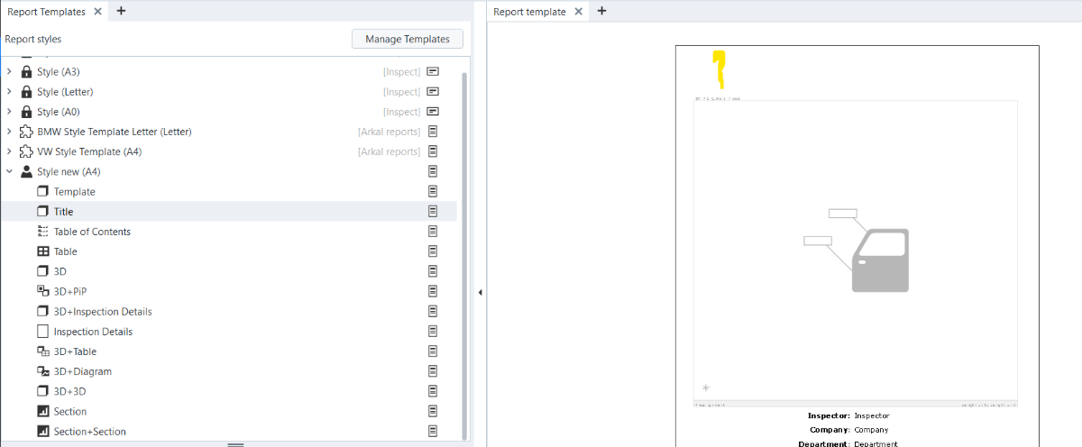

[Ka...] Posted April 30 Share Posted April 30 Hi, you still look onto the Report template, but you should look onto the report master -> please select in the Report styles explorer the "Style new (A4)" Maybe this video helps for better understanding: I created a new report style (which has no elements on its Report Master), copied the Title Template from the Inspect Style (which does not contains the Report title) element (as this element is located on the Report master of the Inspect report stylw) and select the report master of the new created style and simply added a "Report Title" element - I changed also the background color for a better visibility -> this element from the Report master is also visible on the template then change_reportmaster.mp4 Link to comment https://qualityforum.zeiss.com/topic/26477-create-report-style/#findComment-149894 Share on other sites More sharing options...
[Al...] Posted May 3 Author Share Posted May 3 Hello Karin, Great, thank you for the explanations and support. Link to comment https://qualityforum.zeiss.com/topic/26477-create-report-style/#findComment-150000 Share on other sites More sharing options...
