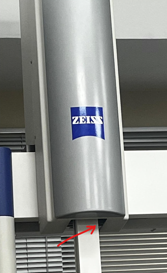

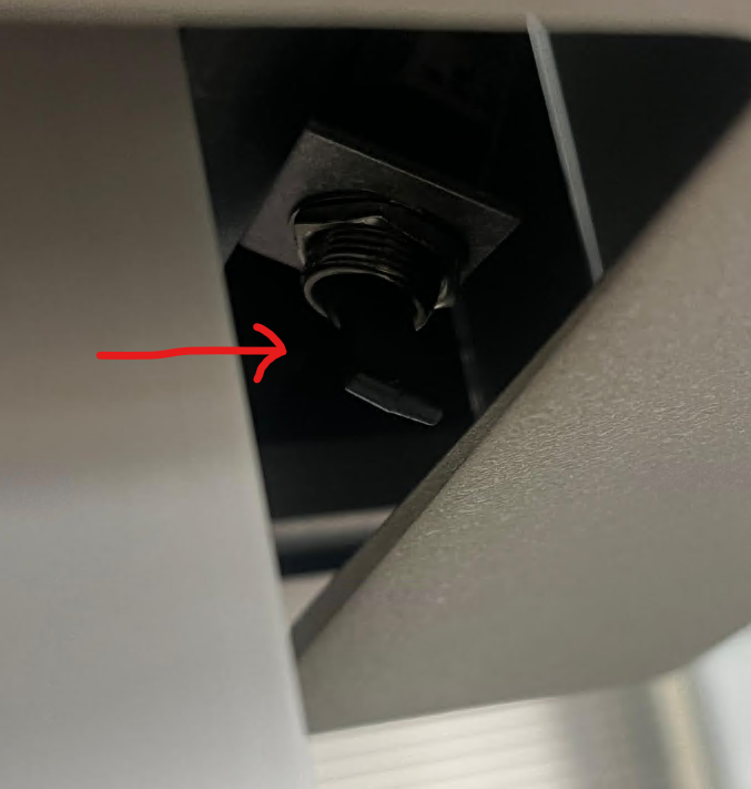

[Ün...] Posted May 4 Share Posted May 4 I experienced this a few times with the Contura device, but I don't remember if it was the same message. Turn on the air switch on the device's cover and move it manually in all three axes, then turn it off and send it to the reference point. Link to comment https://qualityforum.zeiss.com/topic/26516-it-does-not-establish-a-starting-position/#findComment-150020 Share on other sites More sharing options...
[Da...] Posted May 4 Author Share Posted May 4 Please sign in to view this quote. Can you tell me exactly where that key is? Link to comment https://qualityforum.zeiss.com/topic/26516-it-does-not-establish-a-starting-position/#findComment-150022 Share on other sites More sharing options...
[Ün...] Posted May 4 Share Posted May 4 Link to comment https://qualityforum.zeiss.com/topic/26516-it-does-not-establish-a-starting-position/#findComment-150030 Share on other sites More sharing options...
[Da...] Posted May 4 Author Share Posted May 4 Please sign in to view this quote. Okay, thanks. On the Accura II, it's like a button that acts as a purge valve. I've tried it, and nothing. I guess I'll have to call a repair shop. Thanks anyway. Link to comment https://qualityforum.zeiss.com/topic/26516-it-does-not-establish-a-starting-position/#findComment-150034 Share on other sites More sharing options...
