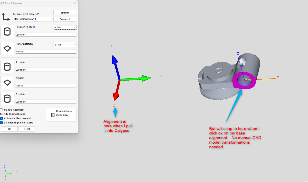

[Ch...] Posted May 8 Share Posted May 8 Are you doing all these CAD transformations before you do the base alignment? For example, you pull in your model, then adjust it to fit the trihedron. If so, you don't need to do that. Pull in your model, then select the features used for your base alignment. You'll see a new trihedron show up with the correct orientation, once you create your base alignment, it will snap to that orientation. If for some crazy reason you were insistent on having the coordinate system in the correct location BEFORE you made your base alignment, then it'd be easier to pull it into solidworks first and create your coordinate system there. 1 Link to comment https://qualityforum.zeiss.com/topic/26564-is-there-a-better-way-to-orient-cad-model/#findComment-150362 Share on other sites More sharing options...

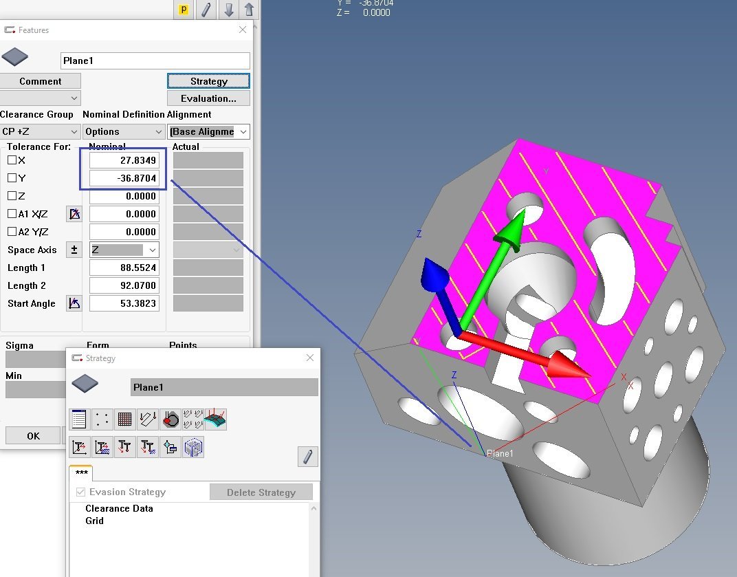

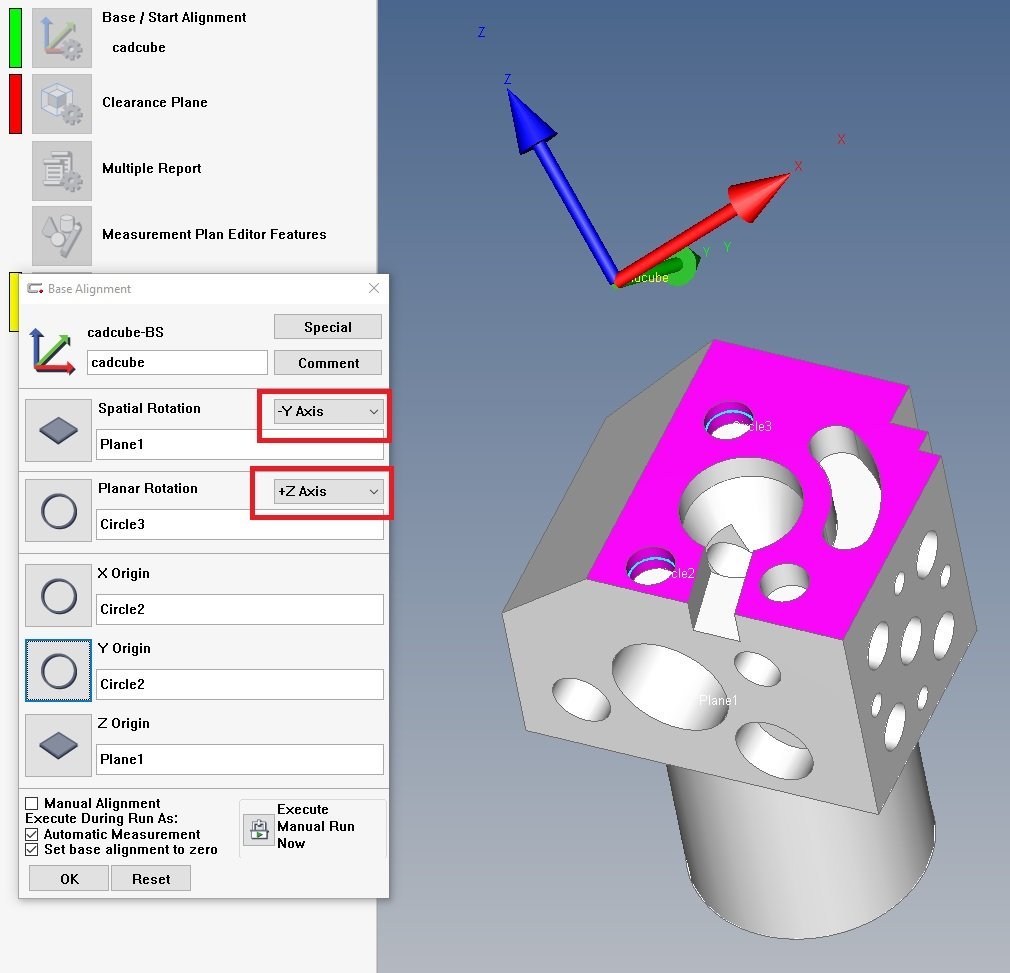

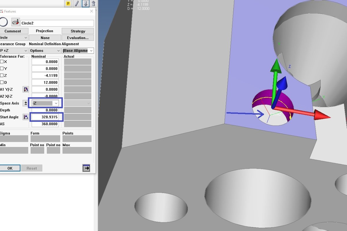

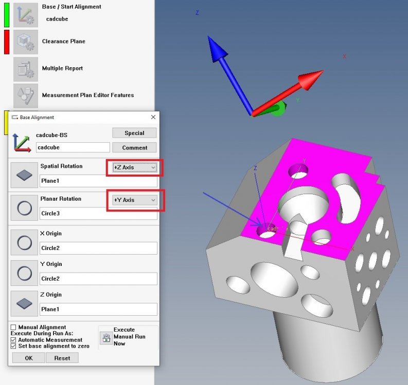

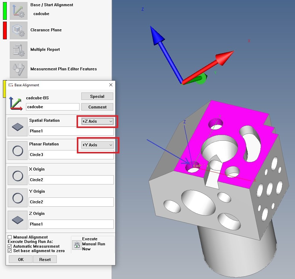

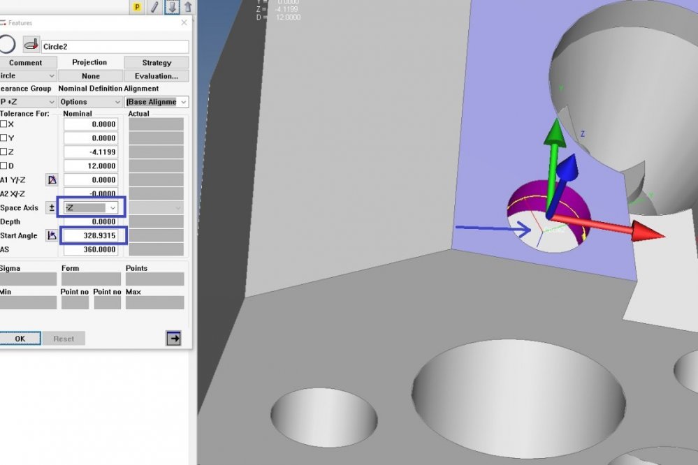

[To...] Posted May 8 Share Posted May 8 (edited) My normal routine is to load a CAD model, immediately go to CAD > Modification > CAD Model transformation and rotate about the axes until I have the model oriented in the same direction as it is sitting on the table. I don't worry about translations as the BA usually handles that with no issues. However, if the trihedron is in unusual orientation, I do the steps listed below. Another method is to create a base alignment by assigning the desired features to the Spatial , Planar and origins. For example, if you extract a plane that you want in the +Z direction and it is in the +X direction according to the model's trihedron, assign it to the Spatial / Rotation in Space. It will detect that the plane is facing the +X direction in the dropdown menu on the right. Select +Z and it will rotation the lighter trihedron to show Z facing up. Next, I would assign that plane to the Z Origin. If I am using a circle/cylinder for the X/Y origin, I like to assign it to the X and Y origin before working on the Planar. Then, assign the planar feature but I pay attention to the direction dropdown menu to make sure it gets assigned properly. There is a good possibility that it will choose the wrong direction because of the orientation of the model. It doesn't know that you are changing the orientation as it is working from the original trihedron's orientation. I check the orientation and location of the "lighter" trihedron to make sure it is located and oriented the way I want. Then, I click OK and the original "bold" trihedron moves to the desired location. This process works well when the original trihedron is at a weird orientation. Here's where I take a few more steps. I delete the features the I created for the BA. I go back into the BA and create a "NEW" BA. The reason for this is when I extracted the features in the first pass, the properties of those features were based on the model in its' original orientation and in some cases, it will create odd behavior for some strategies. Below, is an example of what I mean. By re-creating the BA alignment with new features, the feature's coordinate systems make more sense. Now, you might say "why waste the time, it really doesn't matter" and you would be right but I prefer to have my features in a structured format. i.e. when working on strategies, I occasionally work in the "feature's coordinate system" and if it's skewed or in a different orientation, it is a bit more challenging. It's a personal preference. Edited May 8 Link to comment https://qualityforum.zeiss.com/topic/26564-is-there-a-better-way-to-orient-cad-model/#findComment-150366 Share on other sites More sharing options...
