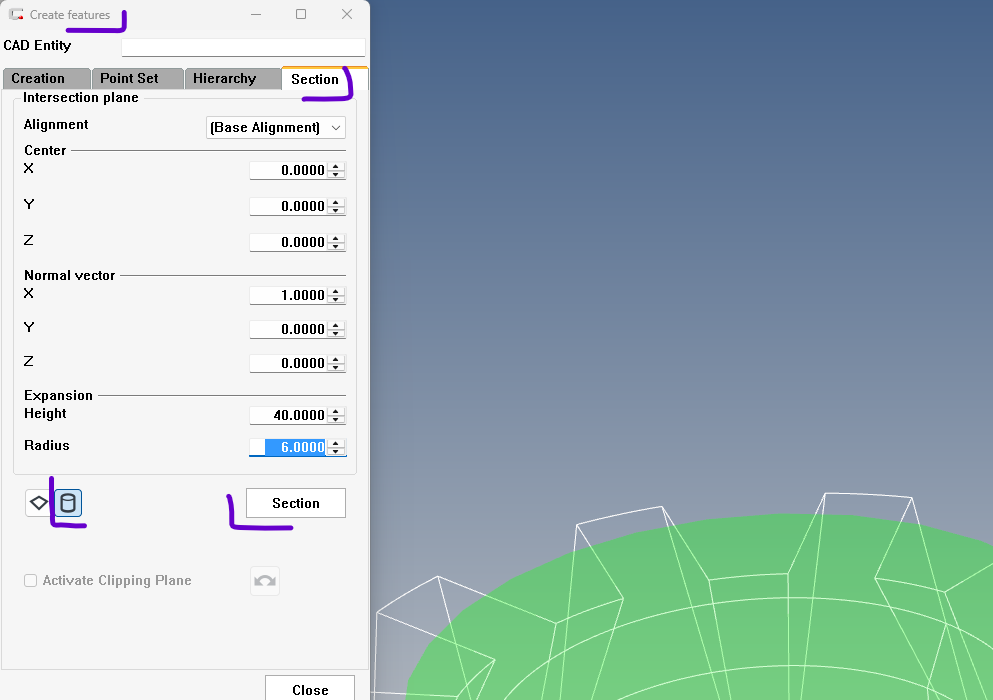

[Ma...] Posted May 8 Share Posted May 8 Howdy! I’ve got this dog gear part with a line profile callout, and I’m not really sure how to collect all the features needed to create a 3D line. I’m trying to create a scan path along the red line shown in the image. Any help or guidance would be greatly appreciated! Side question: What’s the best way to mask out small point sections in the bottom corners to help with evaluation? Link to comment https://qualityforum.zeiss.com/topic/26570-3d-line-path-on-dog-gear/ Share on other sites More sharing options...
[na...] Posted May 8 Share Posted May 8 Please sign in to view this quote. Go to CAD -> Creating features and set it to cylindrical section. Then pick the section and make 3D curve. 2 1 Link to comment https://qualityforum.zeiss.com/topic/26570-3d-line-path-on-dog-gear/#findComment-150338 Share on other sites More sharing options...
