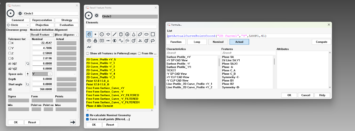

[Iv...] Posted May 27 Share Posted May 27 Please sign in to view this username. Sounds like you found a working solution. Unfortunately, I cannot offer you another solution 😅, but I feel like I'm pretty close, so I wanted to share it anyway. From my understanding, the box-range region was used in your approach. I'm not the greatest fan of the box range since I do not feel like it is too precise and can lead to unwanted points. My preferred method is a point range, so my approach tried to utilize that method. Create a new circle and select the recall feature points. Scroll to the bottom of the feature list and right-click between the area of the last feature and the border of the feature list window. If done correctly, you will see a pop-up that lets you select "formula" as an option. Was there, I was hoping to add a point range, but this is where things stalled out. Using the getActualCurvePointCoord function, I'm able to output to access the coordinates of the points. As shown in the screenshot below, I currently have the "Y" coordinate output for the 41 point. You can easily substitute other coordinates or point numbers by changing those values. But I couldn't find a formula to output a point range. Not sure if there is a function available. If there is, my next plan was to add the list function in front of the feature, which would allow me to loop between the curves. My final formula would look something like the following. getActualCurvePoint(list("Cruve"+LOOP1),10)-getActualCurvePoint(list("Cruve"+LOOP1),40) In the formula above, 10 and 40 represent the point ranges. The Loop function will then allow you to switch between the curves. As I said, it's a current working solution, but I felt it was pretty close that maybe someone with more PCM/Zeiss function knowledge could help bridge the gap. Link to comment Share on other sites More sharing options...
[Ma...] Posted May 27 Share Posted May 27 Please sign in to view this username. Hi and thanks for a reply. I have a strange problem where on old Calypso i could use a basic PCM calls ( "function" button ) but on newer version i can not open that. I have also tried to use formula like in your 2nd window, but i can not do that. I was trying to recall measured points as range, but i could not obtain for each circle element it's corresponding points. Every circle got all points and it was acting wierd. Also i wasn't used to use loops and divisions so i thought it would be faster to just scan it, return the part and evaluate later. Now i won't be measuring every slot on the part, so no need to go through such pain 😄 Link to comment Share on other sites More sharing options...
[Iv...] Posted May 27 Share Posted May 27 Makes sense! This method does not use any PCM either. It's a little tricky to get the formula to pop up. You have to stay perfectly inside the region shown below. And I've noticed that if you don't get it right on the first time and mistakenly select a feature instead, the formula option will no longer appear, and you have to create a new feature. Let me know if that works for you. 1 Link to comment Share on other sites More sharing options...
[Ma...] Posted May 28 Author Share Posted May 28 Please sign in to view this username. Unfortunatelly i don't have that option there. Last 2 lines are missing. I am on 7.8.18 Link to comment Share on other sites More sharing options...
