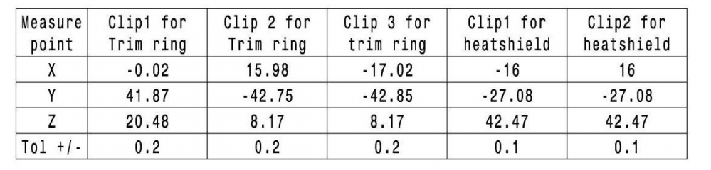

[邹...] Posted February 22, 2023 Share Posted February 22, 2023 The position of the coordinate point is the position of the global coordinate system. What is the measuring principle used when creating coordinates of points? The point is the center of the cylinder. thank you! Link to comment https://qualityforum.zeiss.com/topic/2660-the-creation-of-space-points-and-the-measurement-principle-used/ Share on other sites More sharing options...
[Je...] Posted February 24, 2023 Share Posted February 24, 2023 Hello The position of the coordinate point is the position of the global coordinate system. What is the measuring principle used when creating coordinates of points? The point is the center of the cylinder. thank you! Maybe you can add a screenshot what you want to evaluate? If it really is a cylinder, you need to construct it manually (A point cannot be used a cylinder // there is no matching measuring principle). Best regards, Jens Braun Link to comment https://qualityforum.zeiss.com/topic/2660-the-creation-of-space-points-and-the-measurement-principle-used/#findComment-7007 Share on other sites More sharing options...
