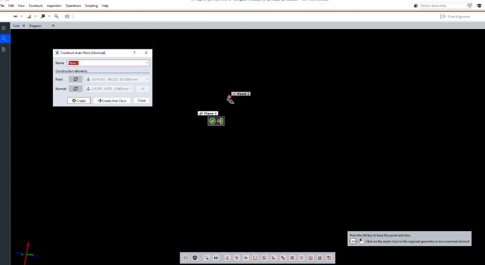

[Th...] Posted February 22, 2023 Share Posted February 22, 2023 I have issues when creating elements in GOM Inspect 2021. I can pull in cad and mesh. I can construct a point. when i attempt to construct most other features (Plane, rectangle, etc..) my screen turns black. I don't think my graphics card is on the list of compatibles. Maybe the issue? Any ideas? Link to comment Share on other sites More sharing options...
[Th...] Posted February 22, 2023 Author Share Posted February 22, 2023 After Updating to the 2022 Gom software, I no longer have the issue. Easy solution! Link to comment Share on other sites More sharing options...
