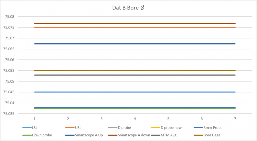

[Jo...] Posted 23 hours ago Share Posted 23 hours ago Hey All, I am coming across an issue measuring a Bore ID (75.06±.015) that does not correlate with the supplier or other measurement systems. We have tried various tests comparing different methods with the attempt to troubleshoot. Below is a chart comparing different results. D probe = regular production probe (5mm) D probe new = replaced/recal (5mm) 3mm probe = choosing a smaller probe size per cookbook down probe = measuring the bore oriented upright instead of on its side smartscope A down/A up = measuring a circle on each side of the part MTM avg= average measurement of the suppliers' results Bore gage measurement We measure the Bore as a cylinder at 3 sections @ cookbook settings. Any thoughts or suggestions for what could be going on? TIA! Link to comment Share on other sites More sharing options...

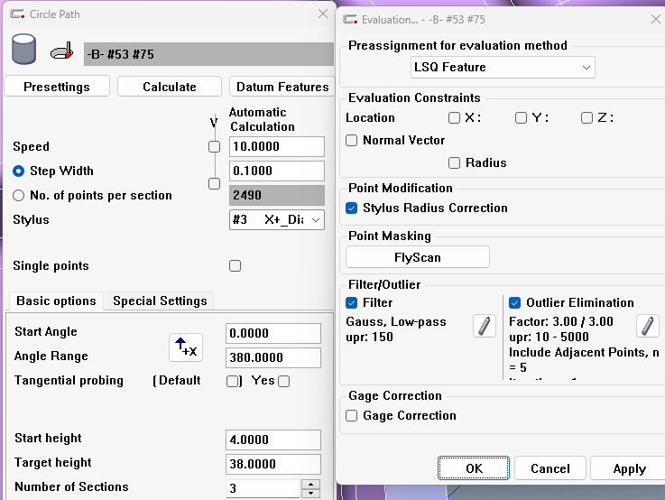

[Do...] Posted 23 hours ago Share Posted 23 hours ago Have you compared values when adjusting your evaluation method from LSQ to outer tangential? Link to comment Share on other sites More sharing options...

[Jo...] Posted 22 hours ago Author Share Posted 22 hours ago Please sign in to view this username. Please sign in to view this username. Outer tangential shows even smaller. Cylindricity shows 0.009mm Breaking the cylinder into individual Øs shows results within a few microns of each other. 75.0363 75.0386 75.0353 We have matched the supplier's method with no noticeable change. They use a Hexagon CMM. Link to comment Share on other sites More sharing options...

[Jo...] Posted 21 hours ago Author Share Posted 21 hours ago Please sign in to view this quote. Read my mind, this was my next verification. We measured a 75.09mm ring gauge. The gauge came in at 75.073mm, so this is roughly 0.017mm under spec and aligns with the delta we are seeing vs the supplier. So what now? Is the vast head or CMM off? Should we look to get it checked out by Zeiss? Anything else I should do to verify? 1 Link to comment Share on other sites More sharing options...
