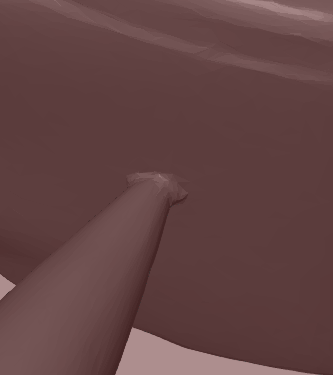

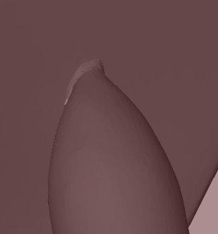

[Se...] Posted May 27 Share Posted May 27 (edited) I have a part assembled with 4 pins that are embedded in the part, as shown in the picture. How can I make the script or program detect and remove them? the pins are not in one and the same place, they may differ slightly in distance from subsequent scans Edited May 27 Link to comment https://qualityforum.zeiss.com/topic/26706-please-help-the-program-automatically-removes-pins-from-the-part/ Share on other sites More sharing options...
[Na...] Posted May 27 Share Posted May 27 Hi Sebastian, is the part aligned to a CAD? You could select the mesh belonging to the part with select by mesh, invert the selection and delete. There are many other selection tools to fine tune the selection. During measuring there is cut out points outside CAD available, so the measuring data is filtered during acquisition with supported sensors. Nanno Link to comment https://qualityforum.zeiss.com/topic/26706-please-help-the-program-automatically-removes-pins-from-the-part/#findComment-151134 Share on other sites More sharing options...
[Se...] Posted May 28 Author Share Posted May 28 The program does not have a built-in CAD system. If I upload a CAD file and perform local alignment, is that sufficient, or should I do it differently? Since I scan parts, then perform polygonization, and afterwards remove the 4 pins attached to the part (as shown in the images in the previous correspondence), how can I make these pins be removed automatically? Or do you perhaps have any presentation I could use to set this up? The pins will be located in different places. The goal is that after polygonization and obtaining the G3D file, the pins are automatically removed so that I do not have to remove them manually. Can you help me with this Link to comment https://qualityforum.zeiss.com/topic/26706-please-help-the-program-automatically-removes-pins-from-the-part/#findComment-151170 Share on other sites More sharing options...
[Ma...] Posted May 28 Share Posted May 28 If you are scanning that, then you can remove background points with help of CAD model. Otherwise a small python script can help to do that, if you can replicate steps to obtain your desired result. Link to comment https://qualityforum.zeiss.com/topic/26706-please-help-the-program-automatically-removes-pins-from-the-part/#findComment-151172 Share on other sites More sharing options...
[Jo...] Posted May 28 Share Posted May 28 Are those pins from a fixture / target frame? There are also possibilities to remove fixtures and the pins will propably not be at the exact same spots on the part, but on the exact same spots relativ to the rest of the fixture. Link to comment https://qualityforum.zeiss.com/topic/26706-please-help-the-program-automatically-removes-pins-from-the-part/#findComment-151174 Share on other sites More sharing options...
[Se...] Posted May 28 Author Share Posted May 28 The mounting pins, as in the picture, are attached in a very similar manner. My Python knowledge is limited. I can insert CAD into the program and base the parts against CAD using Local BestFit, but I would like it to be automatic and remove the pins automatically. But I don't know how do this. Can someone tell me step by step Link to comment https://qualityforum.zeiss.com/topic/26706-please-help-the-program-automatically-removes-pins-from-the-part/#findComment-151176 Share on other sites More sharing options...

[Se...] Posted May 28 Author Share Posted May 28 Please sign in to view this quote. I've already recorded the script, and unfortunately, I can't place the pins on the part in the exact same place every time, and I have 36 parts parts. The script deleted them in a different place each time. Link to comment https://qualityforum.zeiss.com/topic/26706-please-help-the-program-automatically-removes-pins-from-the-part/#findComment-151182 Share on other sites More sharing options...

[Se...] Posted May 28 Author Share Posted May 28 If I record and have a script, when I install another part and the pin moves to the right or left, the pin isn't removed. Unfortunately, I don't know how to do this by uploading CAD and comparing it with the mesh. The pins are incorporated into the part's structure. Link to comment https://qualityforum.zeiss.com/topic/26706-please-help-the-program-automatically-removes-pins-from-the-part/#findComment-151186 Share on other sites More sharing options...
[Na...] Posted May 28 Share Posted May 28 This code worked for me in a sample project. Make sure the mesh is aligned (eg prealignment) to the CAD and only the mesh is the only element visible in the explorer. If the part structure is more complicated you can reach out to your local support and show them the project. # -*- coding: utf-8 -*- import gom #re-record select by mesh with parameters that work well for your project if needed gom.script.selection3d.select_by_mesh ( max_distance=1.001, max_normal_angle=0.436332313, mesh=gom.app.project.parts[0].nominal, respect_normals=False, restrict_actual_selection_to_nominal=False) #inverts selection -> pin mesh selected gom.script.selection3d.invert_selection () #selected mesh is deleted gom.script.cad.delete_selected_3d_area (reset_deviation_values=True) Link to comment https://qualityforum.zeiss.com/topic/26706-please-help-the-program-automatically-removes-pins-from-the-part/#findComment-151188 Share on other sites More sharing options...
[Se...] Posted May 28 Author Share Posted May 28 Please sign in to view this quote. 1.I must copy in project CAD 2. Scaning parts ( polygonize ) 3. localbestfit on cad and mesh 4. then run scrypt?? Link to comment https://qualityforum.zeiss.com/topic/26706-please-help-the-program-automatically-removes-pins-from-the-part/#findComment-151190 Share on other sites More sharing options...
