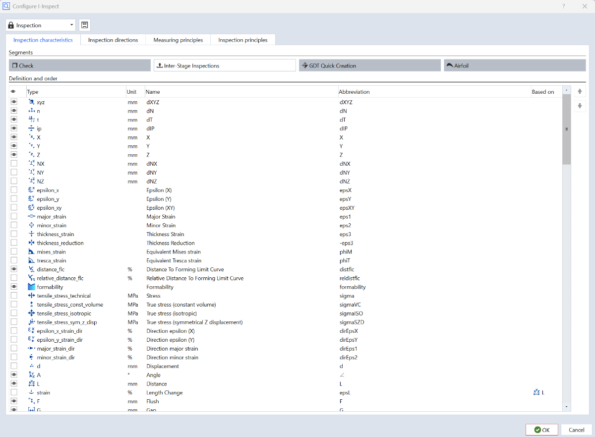

[F....] Posted May 27 Share Posted May 27 (edited) Hello, I am trying to inspect surface point by exporting i, j, k not only x, y, z. I only could see I-tech has x, y, z from drop down list. Does it Dnx, Dny, Dnz? Would someone could help me? Thanks, Edited May 27 Link to comment https://qualityforum.zeiss.com/topic/26712-inspect-i-j-k-and-export/ Share on other sites More sharing options...
[Ma...] Posted May 28 Share Posted May 28 (edited) For me it was working selection from main menu - there is dN(xyz) and it was working on surface point Edited May 28 Link to comment https://qualityforum.zeiss.com/topic/26712-inspect-i-j-k-and-export/#findComment-151212 Share on other sites More sharing options...
[F....] Posted May 28 Author Share Posted May 28 i, j, k are not Dn(x,y,z). They are vector of point and features. Link to comment https://qualityforum.zeiss.com/topic/26712-inspect-i-j-k-and-export/#findComment-151242 Share on other sites More sharing options...
[Ma...] Posted May 28 Share Posted May 28 Please sign in to view this username. oh sorry, it should kick me in the eyes when i saw those results. What would be correct then? I know it can be extracted via user defined check. Link to comment https://qualityforum.zeiss.com/topic/26712-inspect-i-j-k-and-export/#findComment-151248 Share on other sites More sharing options...
[F....] Posted May 28 Author Share Posted May 28 I tried to find from user defined, but there is nothing as i, j, k Link to comment https://qualityforum.zeiss.com/topic/26712-inspect-i-j-k-and-export/#findComment-151262 Share on other sites More sharing options...
[Ma...] Posted May 28 Share Posted May 28 I was using in user defined "Normal" -> actual.normal.y... That would report as vectors Link to comment https://qualityforum.zeiss.com/topic/26712-inspect-i-j-k-and-export/#findComment-151264 Share on other sites More sharing options...
[F....] Posted May 29 Author Share Posted May 29 (edited) Martin, I had tried by scripting, however actual.normal.y isn't works. Is it the way you are using in user defined "Normal" -> actual.normal.y..? Could you please show me step by step how did you do that? Thanks, Edited May 29 Link to comment https://qualityforum.zeiss.com/topic/26712-inspect-i-j-k-and-export/#findComment-151364 Share on other sites More sharing options...
