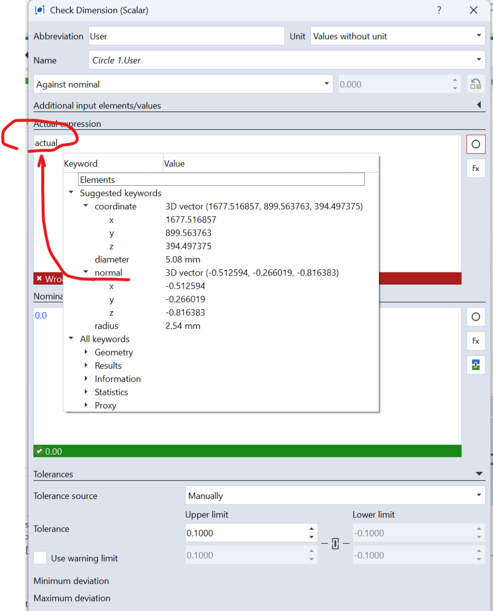

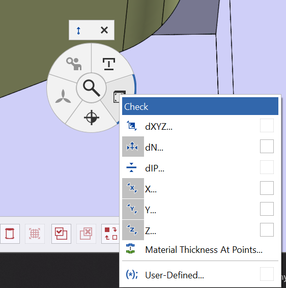

[F....] Posted May 27 Share Posted May 27 (edited) Hello, I am trying to inspect surface point by exporting i, j, k not only x, y, z. I only could see I-tech has x, y, z from drop down list. Does it Dnx, Dny, Dnz? Would someone could help me? Thanks, Edited May 27 Link to comment Share on other sites More sharing options...
[Na...] Posted May 29 Share Posted May 29 Hi, you can access the values with a user defined check, which can be added to I-Inspect (and saved in an App to have it available across projects. Nanno 1 Link to comment Share on other sites More sharing options...

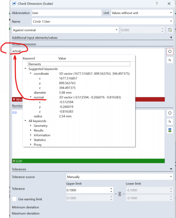

[F....] Posted May 29 Author Share Posted May 29 Thanks. However, I tried it on circle center point, there is no actual 3d vector for selecting, only nominal. Is there any way I could find out actual reading? Link to comment Share on other sites More sharing options...

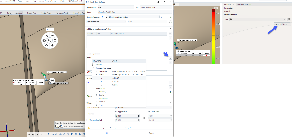

[F....] Posted May 29 Author Share Posted May 29 Thanks. However, I tried it on circle center point, but the nominal reading and actual reading are same. I have to manual type nominal value in the Nominal expression box below actual expression. Link to comment Share on other sites More sharing options...
[Na...] Posted June 1 Share Posted June 1 Usually, you define the actual expression and then click on the blue/green symbol right of the Nominal expression. The actual expression is then 'translated' to nominal expressions. If the results are the same, the circle probably has the same normal. For example if it is constructed in a section with measuring principle 'actual section'. Link to comment Share on other sites More sharing options...
