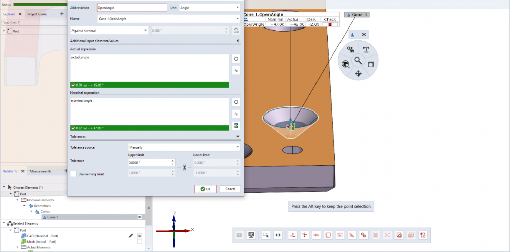

[Ti...] Posted February 26, 2023 Author Share Posted February 26, 2023 Here is what I did as a temporary solution. I am looking to get the angle of a countersink hole. I measured the ellipse intersection of the top plane and the cone. I created a plane 1mm under the top plane. I measured another ellipse interesection of this plane and the cone. With a known distance of 1mm in height and a known difference in both diameters I can create the angle of the cone with user defined parameters: Link to comment https://qualityforum.zeiss.com/topic/2679-angle-of-a-cone/#findComment-7021 Share on other sites More sharing options...

[Be...] Posted March 2, 2023 Share Posted March 2, 2023 Hi, may be I misunderstood you but why don't you use simply the 'angle' token from the cone in a user defined expression (or with some small formulas you can double the angle). You do not have to create further elements if you only need them for the angle calculation. See the attached image Regards, Bernd Link to comment https://qualityforum.zeiss.com/topic/2679-angle-of-a-cone/#findComment-7057 Share on other sites More sharing options...
[Ti...] Posted March 4, 2023 Author Share Posted March 4, 2023 Please sign in to view this username. I'm an idiot, I can't believe I didn't see that you could measure the cone with a right click. I do need to double it for our output but this helps alot. Thank you. Link to comment https://qualityforum.zeiss.com/topic/2679-angle-of-a-cone/#findComment-7073 Share on other sites More sharing options...
