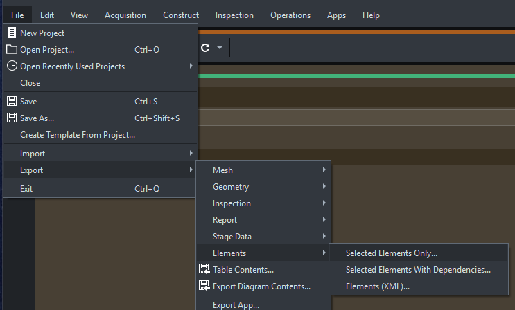

[No...] Posted June 23 Share Posted June 23 (edited) Inspect hat m.W. keine Exportfunktion für CAD-Modelle, egal in welchem Format. Ist leider nicht so wie in Calypso. Edited June 23 Link to comment https://qualityforum.zeiss.com/topic/26857-cad-modell-ersetzen/#findComment-152043 Share on other sites More sharing options...

[na...] Posted June 23 Share Posted June 23 You can try File -> Export -> Elements -> Selected Elements Only and save to cad.zelements Link to comment https://qualityforum.zeiss.com/topic/26857-cad-modell-ersetzen/#findComment-152047 Share on other sites More sharing options...
