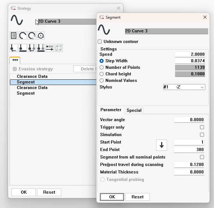

[Ch...] Posted June 22 Share Posted June 22 I have a problem which seems extremely simple but for some reason is giving me a ton of trouble. I am attempting to take what is essentially profile of a line around the inside of a rectangle. The issue lies in the fixturing and sharp corners requiring it to be scanned in six separate sections. I have split it up into six line scan paths and am attempting to recall them into one curve so it can be evaluated but the tolerance is getting very confused in the corners and also is interpolating my scanned points across the gaps which I do not want. I just want a profile tolerance based on the CAD model, controlled by the drf with the actual points being evaluated to it. The attached picture is a sketch of what I am trying to do, with the green being my actuals vs the closest I can get calypso to manage it. I have tried every combination of features types I can think of, 2d lines, 2d curves, 3d lines, 3d curves. Link to comment https://qualityforum.zeiss.com/topic/26861-profile-of-a-line-on-interrupted-segments/ Share on other sites More sharing options...

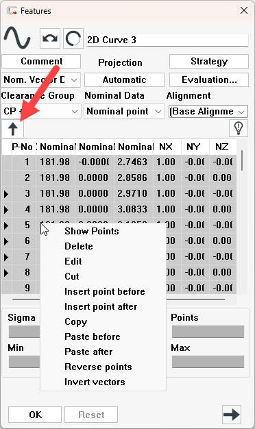

[Iv...] Posted June 22 Share Posted June 22 How are you creating the nominals for the recalled curve? My preferred method is using the connect nominal curves (screenshot below). This will only pull the nominals; you then have to recall feature points from the curves to bring over the actuals. You can also use the "re-calculate nominal geometry" option from the recall feature points pop-up. But make sure there is no actual data in your curve since it will recall the actual for the nominal data For both methods, I would recommend using the curve results points option when recalling the feature points. Another option would be to scan over those sharp corners and mask out those points. This option can be found in the evaluation window under the limit evaluation. This looks like it would reduce the number of scans to 2. Maybe an even better option is using only one curve. Create the full curve. Expand the point list and delete the points that are blocked by the fixture. Lastly, create two segments with a clearance plane in between. Update the start and end points accordingly. This would be my preferred method since it does not involve any recall or combinations of curves. Make sure to make things easier by having the curve start adjacent to one of the fixture locations. 1 Link to comment https://qualityforum.zeiss.com/topic/26861-profile-of-a-line-on-interrupted-segments/#findComment-152029 Share on other sites More sharing options...
[Ch...] Posted June 23 Author Share Posted June 23 Please sign in to view this quote. I did end up going with the last option however the corners still are having issues with the tolerance. They are not smoothly following the profile of the nominal curve as expected and are even a bit tangled in some. Not sure why as the actual curve looks to be correctly matching the CAD. Link to comment https://qualityforum.zeiss.com/topic/26861-profile-of-a-line-on-interrupted-segments/#findComment-152051 Share on other sites More sharing options...

[Je...] Posted June 23 Share Posted June 23 Hi Please sign in to view this username. . Nice work on troubleshooting at least half of the problem. There are a few ways to get those pesky corners omitted from the zone. 1. Under the evaluation tab for the curve, choose the "Limit Evaluation" option in the middle of that window. Then, you will be able to mask out the points near those corners. - Heads-up: This UI can be confusing at first. Make sure you turn on "Show point numbers" before opening the Limit Evaluation window. Then, scroll down to the points you would like to mask. While holding down the control key, click the individual points you would like to mask. If there are several points in a series to mask, you can hold down shift after clicking the first point in that series and click the last point in that series, and it will choose all points between. However, if you don't hold down either control or shift, Calypso will only choose one point and reset all others. Tip: If acceptable per your task, mask a few points on the edge or even outside the corners to make sure outliers don't sneak in to the unmasked area. 2. Newer versions of Calypso facilitate more intricate curve constructions, similar to how Please sign in to view this username. used the connect nominal curves optoin. You can create a curve with nominal point segments for the lines and delete or omit the corners when creating the original curve. This can sometimes have undesirable effects on the tolerance zones, either visually or numerically. I prefer option #1. Tip: Under the evaluation tab, there is an option called "take segment gaps into consideration." You may want to check that option, but I'll be honest that I don't fully understand what's behind the curtain on that function. Tip: You can scan the features of interest as line segments and then recall them or scan entire curve features all-in-one (or a hybrid strategy to avoid obstacles). Curves are like their own Open-World video game. Lots to explore. If you have a ZeissCare agreement, I strongly recommend submitting a ticket and asking the Zeiss application specialists to review your measurement plan. I've learned as much about curves and freeform surfaces from those calls as I have from the actual Curve/Freeform training course. Link to comment https://qualityforum.zeiss.com/topic/26861-profile-of-a-line-on-interrupted-segments/#findComment-152055 Share on other sites More sharing options...
